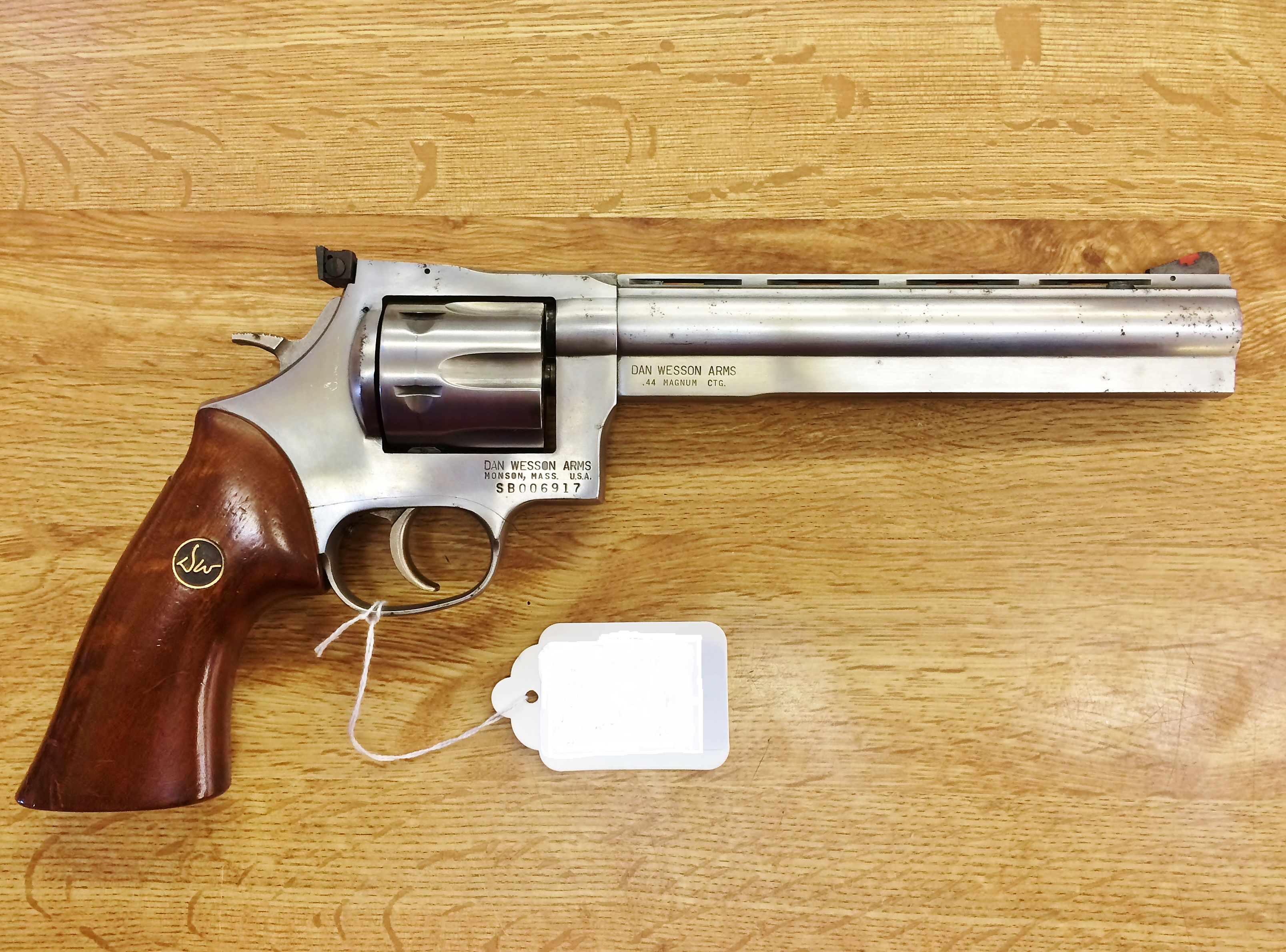

Here is a picture of the 744 I purchased recently. As you can see, it’s had a hard life. For those of you who didn’t think that stainless steel could rust, here’s proof that it can. The pitting is somewhat severe but it has not compromised the integrity of the gun. It still locks up tight. The rifling in the barrel is sharp and true. Looks like whoever owned it before me just didn’t give it the proper love and care it deserved. How some folks can invest money in a gun and then let it go to pot is beyond me. I just felt sorry for the old boy hanging up there on the wall of the gun shop being neglected. Anyway, I’m in the process of restoring it so that I can get it ready for a day at the range. I’ve got some extra parts ordered for it and am waiting for them to get in. So far, it’s coming along pretty good. I found a way of getting the rust out of the pits although I won’t be able to remove them completely. I’ve also learned a way of polishing the stainless steel so that it matches up with the original factory finish. It takes a lot of work (I mean a lot of work!) but it’s looking good. I’m not really interested in making it look brand new. I also know of some gunsmiths who would love to work their magic on it. However, I just want to shoot it! I’m not interested in hanging on the mantel or putting it under glass. I believe Dans were meant to be shot, not gawked at. I’ll post some more pics when I’m finished. Blessings!

I have learned that bead blasting with medium that has been used on blue guns can introduce corrosion to stainless. Also, I think  using steel wool on a stainless gun can also.

Good luck on the restoration. Post some pictures of your progress. What is your process to match the original finish?  I performed a similar restoration on a supermag several years ago. I used fine grit 400-800 sandpaper and purple scotchbrite wheels for my dremel.  I had never seen so much rust in a stainless gun! The guy stored it in a musty leather holster for god knows how long.

The tan scotch brite pads match the stainless finish very closely.  It doesn't take a lot of elbow grease either. Removing the rust is the biggest challenge.  In low-oxygen/ poor circulation environments (shut up in a case or holster) stain-less steel tends to stain more.  The chromium atoms must have oxygen to self-repair and protect from staining.  Scratches and salt (blood) will also destroy the passive film the chromium atoms provide. Regards, Ron
