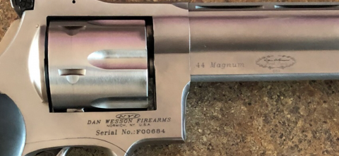

IMG_2169.pngImage Enlarger
Here is my 744VH8 Norwich First Edition.  The serial # on both the frame and barrel match.

DA....64 said
Nice!
Definitely! drool
One of these days I'm gonna land a Norwich First Issue...hopefully in a Pac! cool

The First Issue insignia is on the frame under the grip on the right side I believe.
