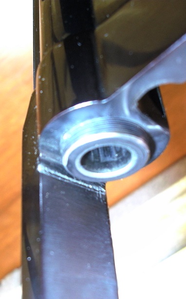

 I have lately become very interested in trying to acquire a Model 40 357 Supermag especially with the Slotted barrel.  I am trying to do my research on the firearm and specifically things to look for when buying considering most everyone will be used.  I heard about flame cutting the top strap that plagued guns chambered in the round from the get go and currently reload so know to keep the bullets to the heavier weight variety, but for the most part it will probably be fed 357 mags and 38s which I have heard is fine so long as I'm proactive about keeping the cylinder clean from the powder of the shorter cases.
The point of all this really is, I'm not looking for an overly collectible piece but don't want to have problems down the road either, but I have found a gun and know it has had about 250 rounds of 357 Maximum run through it and not sure how much flame cutting is really acceptable?

That looks like a fairly minimal amount of flame cutting to me. Also, remember that the flame cutting is never going to get so bad that it compromises the safety of the gun.  The flame cutting gets to a certain point (this one looks like it may already be there) and then it never gets any worse because it can't produce enough energy to cut any deeper.
You don't have a thing to worry about, IMHO.  Many of us have and shoot these guns and no one has experienced a failure due to flame cutting,

I run IMR-4227 in mine instead of H110 or win296.    I have read that those can act like a sandblaster in the maximum.
December 8, 2014 - 10:13 pm
Hoss has it!  \ I have wondered if a person could coat the strap with some of the hard coatings!   Mine is cut about like this one and I don't worry about it!

Honestly, I think most of the ".357 Maxi stigma" came about because of the Ruger guns. In the early days, many of those guys would load them hot-n-light, resulting in deep flame cut. As a result, Ruger caved & discontinued their guns after a couple years...DW chose to stand their ground & informed their customers to use heavier bullets, not bullets made for .38's. The TC crowd never had to worry about this, of course. I haven't seen many (only a half dozen) DW's which looked worse than your pic, and none of those have been rendered unusable AFAIK.
So looking at yours, I wouldn't be worried...I would shoot the snot out of it!laughBTW, I run mine with heavy bullets & IMR4227, and my top strap still looks great!  DW's have a TON of meat in that top strap. Anyway, since I have my pic host site open tonight, here's some model 40 gun porn of mine...just to nudge you over the edge.lol2
December 14, 2014 - 2:21 am
That flame cut doesn't look bad at all.  That is a fairly common sight and there is plenty of 'meat' left in that top strap.  I have a few of these guns, all have some degree of cut, all get shot and I don't hold back on the loads either.  Shoot with confidence, buy now :)

I have been researching the 357SM and have read that light bullets and ball powders cause the flame cutting. I remember it was an article by Elgin Gates so I'm pretty sure it was reliable.Yes the cutting can only so deep.The Rugers suffered worse because their forcing cone was only 5 degrees and not 11 degrees like DW. If I remember correctly.
April 1, 2016 - 4:02 pm
I would be more wary about a gun without any flame cutting...

Ole Dog congratulations. Talked to my friend today. Getting ready for competition he had run 600-700 rounds thru his Ruger 357 maximum and noticed the flame cutting had stopped.Worried my friend had gunsmith check it out while he had it apart to re-ream forcing cone to 11 degrees from stock 5 degrees, cutting stopped a little over 6 thousandths of an inch deep, wanting to know why, next step was metal hardness test.It had case hardened area as it flame cut top strap. Self eliminating problem. surprised
