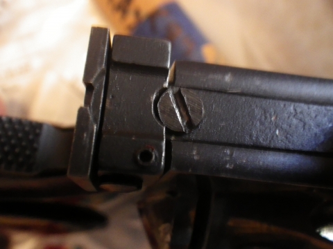

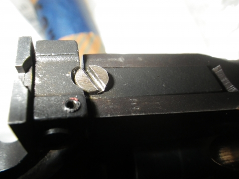

My recently acquired Model 40 has a really loose Rear Sight Plate.   Not even sure this is an original factory sight.   I am not sure how to tighten, and cannot dial it in.  Assuming the rear sights available on DW Webstore is for Small Frame 15/715 only?   Requested availability on replacement from DW, but not hopeful.   Any aftermarket sights out there for Large Frame DWs?   I thought there was a thread in the Forum, but search did not yield match.  Suggestions?

Scout, I think the Ruger sights only fit the later 44's and the small frames. Your sight clearly looks like a early long style 44 sight. However the hold down screw is not correct. that may be your problem. The threads may be messed up and that may be why the wrong screw is used.

There are two different length sights for the 44s. They are not interchangeable. The shorter sight is the same as the small frame sights but the small frame and later 44 sights will not work on the early 44s. I know, I have both.

Unfortunately, the Ruger or Firesight sights won't fit your gun.  Please pay close attention to the length of the sight and the placement of the elevation screw.  I don't think anyone has come up with an alternative for the longer sights with the elevation screw placed rearward on the sight.  The link rwsem posted above shows the two sights together so you can see the differences.
