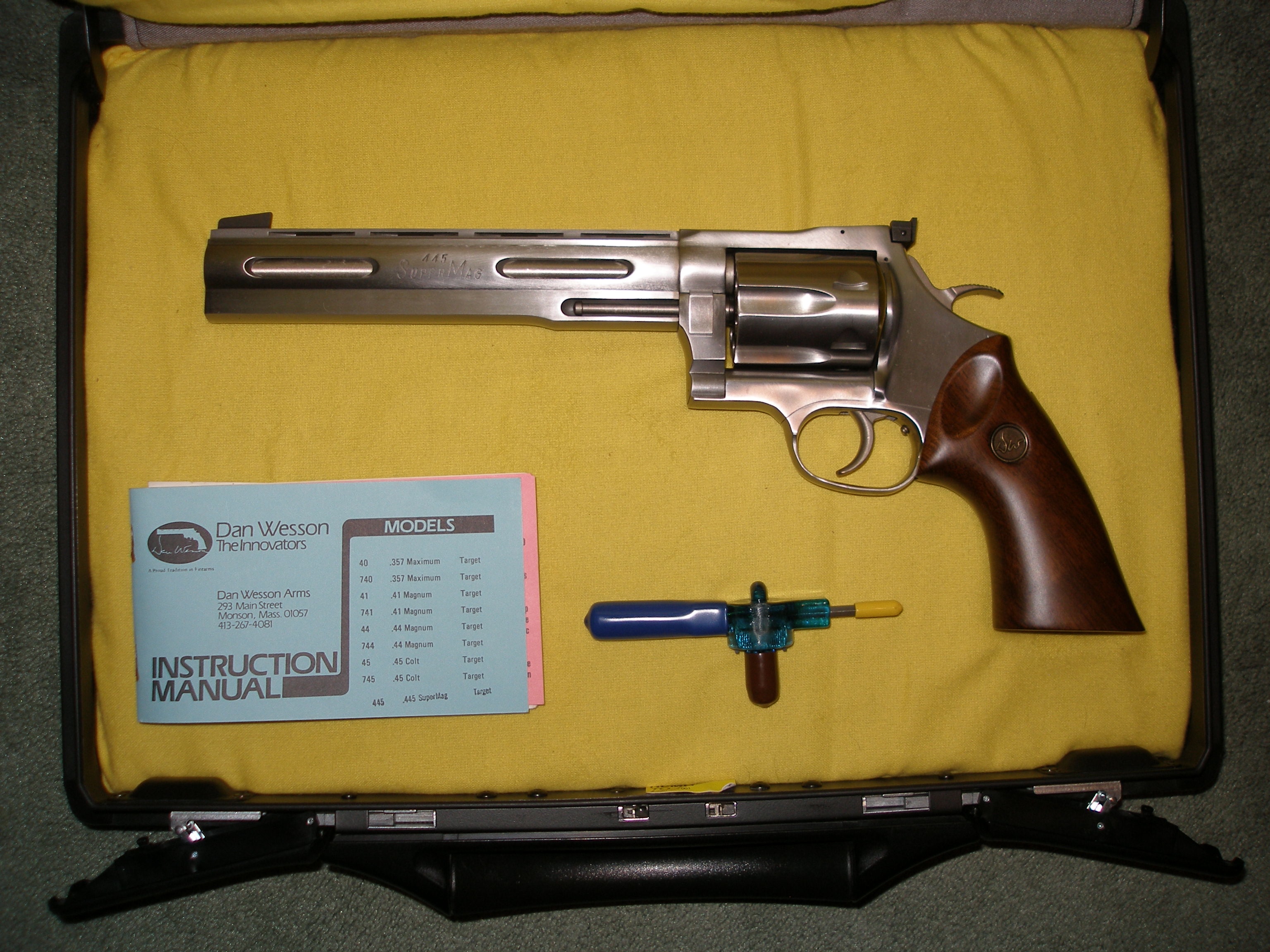

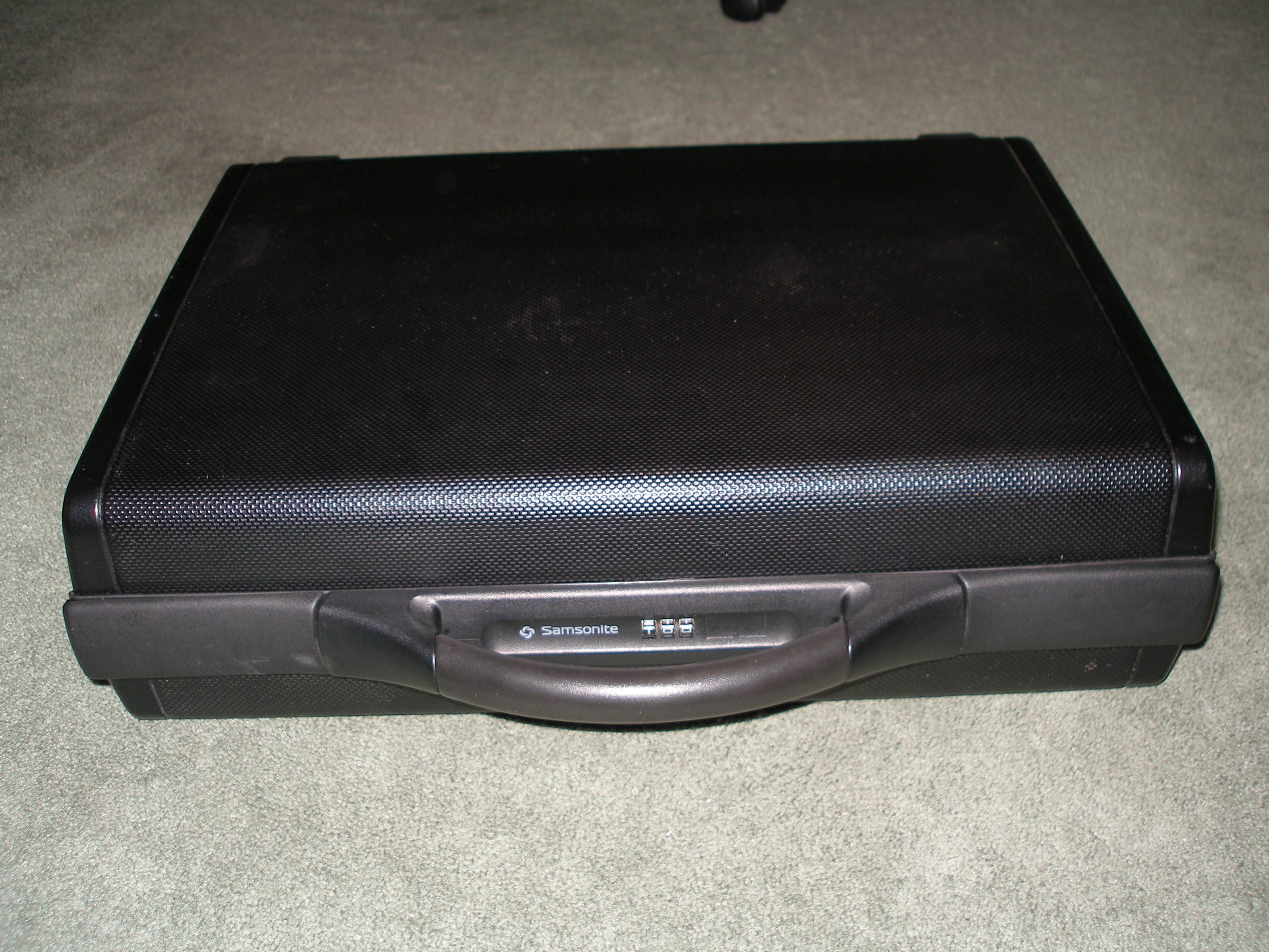

I wanted to give the .445 a nice bed and could not see paying the price for the old beat up DW pistol pack cases they are fetching these days, so I built a better machine. A Samsonite hard shell case, added some gun foam and covered it with yellow flannel for the old school DW look inside. I like this way better as it has a combo lock and heavy duty latches.
She will sleep well nowbig-grin

Nicely done!

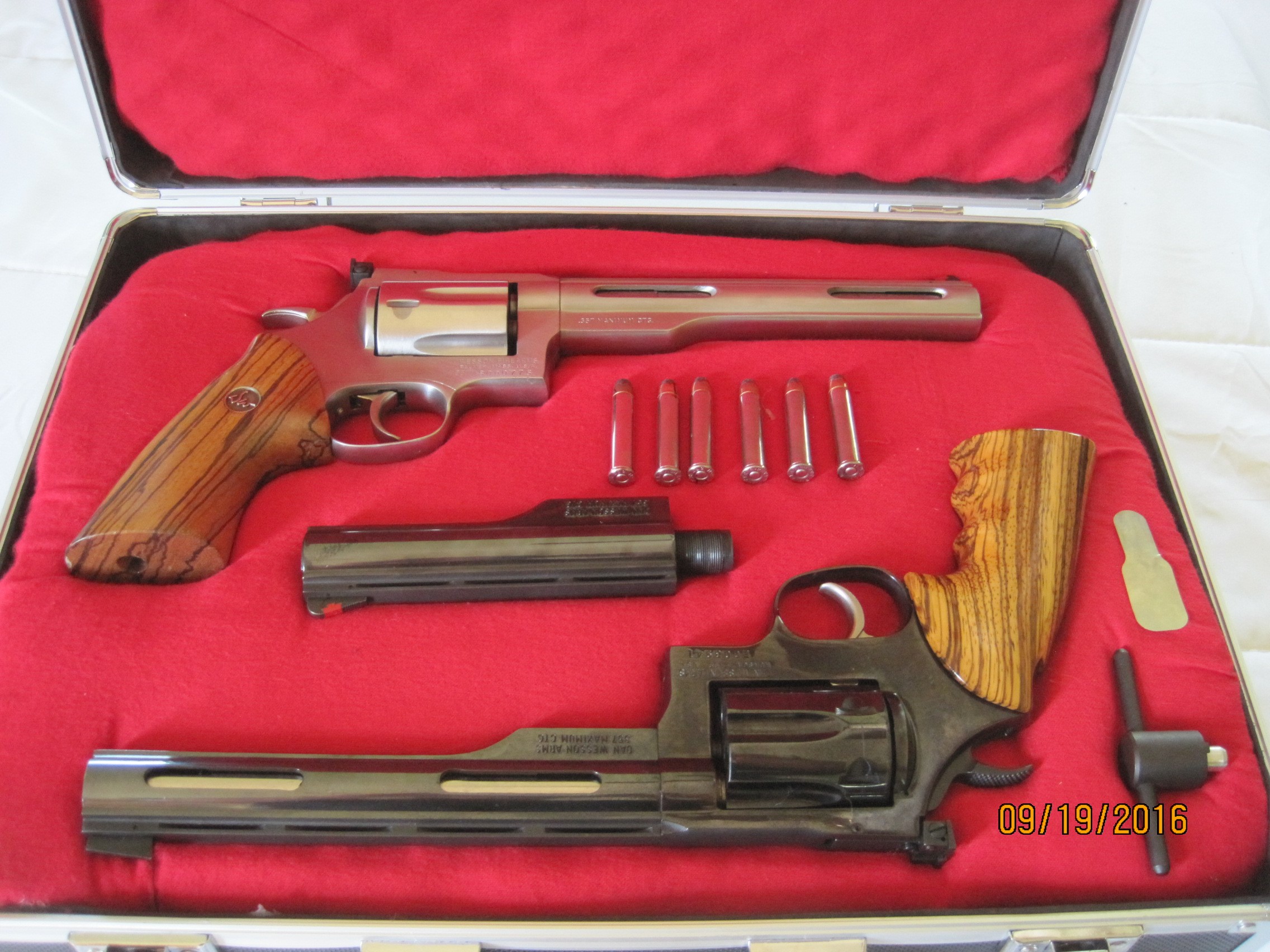

BTW, here's a couple more I made...the first is Pete & Repeat, my Yin/Yang pair of DW 3" FB's...
Then I made a case for my Model 44, with the last of the red stretchy fabric I used in the 1911 case...

I picked up a brief case just like the last one in red, have yet to make the conversion. Got the idea from seeing a 44 mag Hunter Pac in that type case. Hope it turns out that nice.

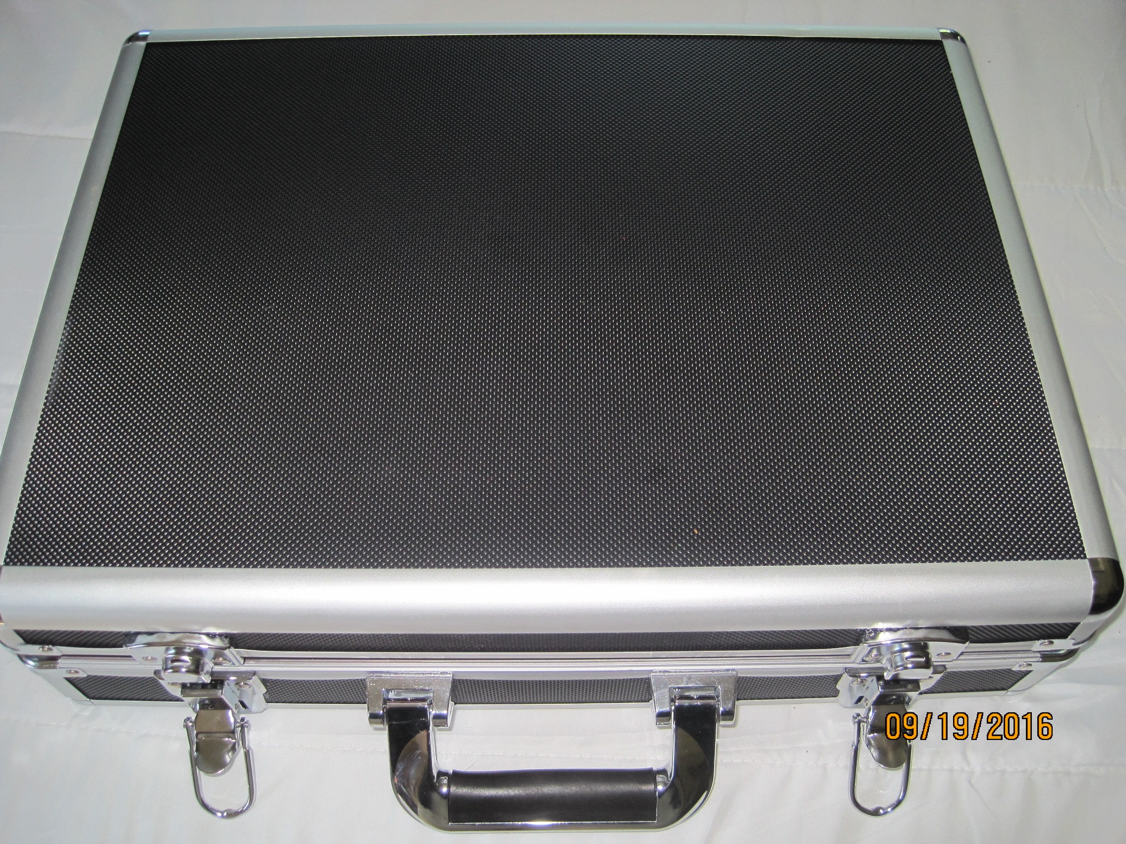

I made a case up for my two Super Mags this weekend check it out!IMG_7761.JPGImage Enlarger
IMG_7762.JPGImage Enlarger
IMG_7763.JPGImage Enlarger
