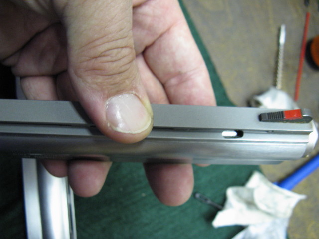

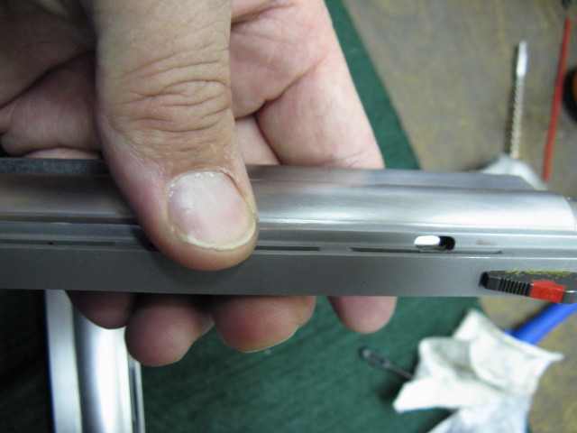

Thanks for the replys/info!
Here's a couple pics of vent.  Does this look right?

November 8, 2010 - 8:23 am
Yep, that looks right for a factory ported shroud.

November 8, 2010 - 9:22 am
Thanks Charger Fan!!  The guy I was shooting with stated that he didn't think it was a stock thing.  I think he's more into S&W and was probably mistaken.
November 8, 2010 - 7:55 pm
conrod- You may still have a ported barrel in there. The DW porting system does not rely on having the barrel ports lined up with the shroud ports. It would be impossible to register the barrel port exactly with the shroud port in an interchangeable barrel system. The porting in a DW relies on a series of (maybe 6?) round ports in the barrel which vent into the shroud. Since the shroud is essentially sealed at both ends, the combustion gasses vent through the shroud ports.
Witn a bore light or flashlight, take a look down the muzzle and check the barrel for ports, or pull the shroud to be sure. If the barrel is ported, pull everyting apart, clean it up good, shoot only jacketed bullets, and clean the shroud and barrel (especially the barrel ports) frequently..

November 9, 2010 - 1:00 pm
Hey Thanks Steve!
I've checked now and no porting on the barrels.  Sounds like this could be a good thing?
November 9, 2010 - 3:03 pm
conrod said:
Hey Thanks Steve!
Yeah, it pretty much is a good thing.  The expansion chamber inside the shroud was very small.  The object was to maintain a high pressure at the shroud exit ports to reduce muzzle flip.  Unfortunately, though it looked great on paper, it wasn't very effective.  The reduction in muzzle flip is negligible, if any.  The cleaning issues are another negative.  You really must clean after each range session.  The inside of the shrould needs to be attacked with a 12ga. bore brush and the outside of the barrel itself needs emery cloth at minimum.  Sometimes a nail file is required to get the junk off.  Then you have to be sure to clean out the holes in the barrel.  And finally, if you shot un-jacketed lead, you're going to have an awful time getting the shroud off of the barrel.
I have both ported and un-ported barrels for each of my shrouds (except the 10-inch, of course) and I haven't shot any of the ported ones in many years.  However, they do complete the collection.
