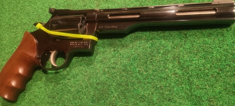

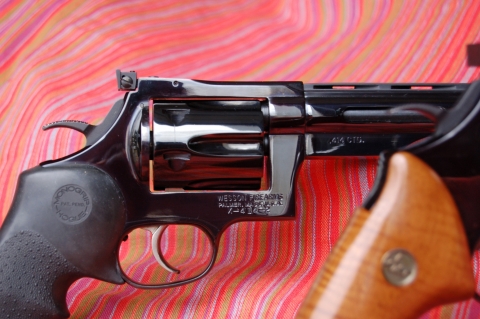

Was asked to share these for appreciation and conversation. A pair of Monson, Ma. One is .375SM and the other a .414SM with extra .375SM barrel and cylinder. Dad got them in the 80s, sequential serials, unfired. Story goes the .414 was experimental then and my understanding is it was not released til a later year. Anyone confirm that or have other info? Have pics, but don't know how to post them.

I sent this to Eric Wesson to try to get some answers! THe gun frames are Monson and there both 375 Supermag frames I think since the serial numbers are almost the same. now the one has a 414 Palmer barrel attached. Then there is an extra cylinder in the pic. Does this mean the gun can become a .414 by changing out the Cylinder? I'm not sure but it's interesting. This got a lot of press on Facebook! At first I thought it may be a gun show gun like my 32-20 but did he have the factory make this into a convertible like a High Standard? Is that possible? The other barrel is not for these guns so I'm thinking most of us is interested in the 0414 part of the story!

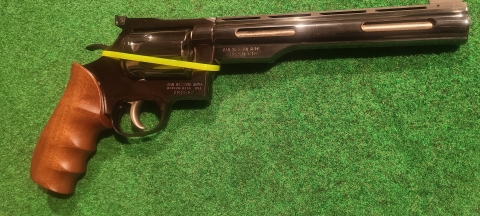

And here they are for your viewing pleasure. The yellow zip ties are from displaying them at a gun show...they are not original laugh

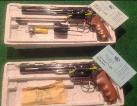

The 375 is a large frame gun so it should be the same as the frame used for a 414. I don't remember you adding the bit about you being told this was a expermetral set that kind of explains everything. They used a similar set up back then when they used a 357 Supermag frame for the 44 Rino guns so it's not uncommon that Dan Wesson used large frame guns already in use to make an experimental gun. I did not think the .414 was made until Palmer years but if they had large frames around they could have used them. I will see what Eric's reply is on the subject. Also you should add the pic showing them in the boxes with the extra cylinder that helps explain the story!

You can't draw the conclusion they are they are both 375 by the serial # and you cannot change calibers on a frame by changing the cylinder or the barrels because the barrels are threaded differently.  They are different for safety to prevent screwing the wrong caliber barrel on a frame and blowing the gun and someones limbs apart.  You can't be changing different caliber barrels on a frame (except .22lr and .22mag, .38 special and .357 mag, and 32 mag and 32-20).
The part that looks strange to me is that the .414SM barrel shroud appears to be a later era, laser etched barrel.  Chip - can you take a look at that barrel shroud and see if it is laser marked?  That style of barrel shroud definitely was not an 80's era production part.  The laser marked shrouds did not come along until the late 90's.  Something's not right on that gun and I'd get some measurements on the chambers and bore and verify exactly what it is.

Chip- DakotaJack brings up a good point.  Are the barrel's threads the same at the point where they screw into the frame? I did a conversion of a 740 (357 Supermag) to 7414 (414 Supermag) recently and re-threaded a .410" barrel to match the 357SM frame's threads.  Most likely, someone did what I've done and fabricated the "experimental" story.  There weren't any 414SM made in blue, particularly during the Monson era, that I've been aware of and DW experimental guns' SNs were marked with an X. The 414 E T Gates started at number 25.
However there may have been some 375 SM frames used at another point; "After the bankruptcies CZ made some 414’s don’t know how many, our last number was 53 of the 25 made, (note Wesson skipped 3 numbers in the original run) But CZ came out with a # 53 also, saw it on line for sale. As another point, Wesson ask us to send them our 375 Supermags we had left. Apparently they ran out of frames to complete our 1-24 414 Revolvers. They went bust before we could get the full order of fifty Revolvers." (Randy Gates conversation).

@DakotaJack Where would a laser marking be on it? Where should i look for it? I don't see anything other than what is visible in the picture - .414 SuperMag. I'll my calipers out and measure everything. Also, reaching out to a friend of dad's who may know more of the story.
That is what he's talking about. The ".414 Supermag" is laser etched, not a rollmark like on the frame.
Forum Posts: 3718
January 18, 2025 - 6:34 pm
Oh, by the way, that means the barrel shroud was manufactured in the Norwich factory years later than the frame in Monson.

Yea that makes the story that this was a prototype gun sold by the Monson or Palmer suspect. That's a Norwich shroud it had to be offered after 1996 correct? I'm not an expert on the roll marks but I thought also that's a Norwich shroud not a Palmer. Maybe he sent it off to Norwich to have the conversion done? THe Cylinder it had to have work done to fit? By the way here is the missing pic showing the cylinder and the Palmer manuals with guns. Click one to enlarge or twice to open a new post to get a even bigger pic! Screenshot-2025-01-18-6.58.18-PM.pngImage Enlarger

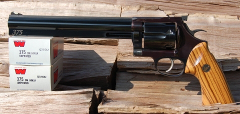

Just for kicks, my 375 with a custom shroud and 9-1/2" barrel.
