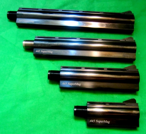

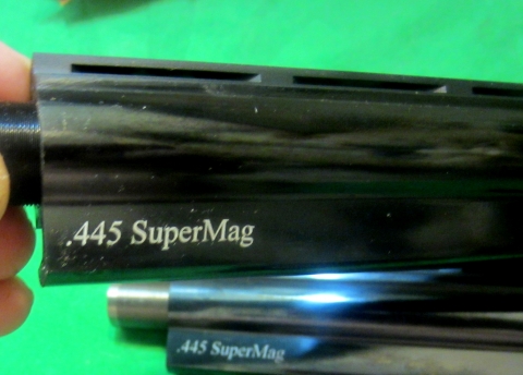

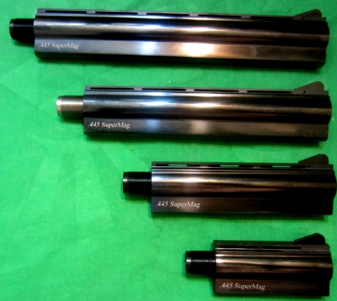

So about a month ago I inquired to Genny about any 445 Barrel assemblies left. She told me no but the next week messaged me and said she found some 445's in bad shape. Told be they would need re-bluing and the 8 inch she only had a stainless barrel but I was in. With the barrels running out as they sell out their not going to be any left soon. Genny got the four barrels together (10VH thru 4VH) and got them fe=done where needed so a big thanks to her!IMG_7629.JPGImage Enlarger
IMG_7627.JPGImage Enlarger
IMG_7626.JPGImage Enlarger
Screenshot-2025-04-07-1.56.25-PM.pngImage Enlarger
I have been told that this is pretty much it for the Dan Wesson parts. Maybe we should start a letter writing campaign to CZ to bring back Dan Wesson Revolvers or at least keep the barrels and parts going! Of course I don't mean an actual letter but email, comment on sites ect though sending actual letters may get more of a reaction. Anyway I got all four barrels in today and very happy I can make a 445 pac with 10VH thru 4VH I know there were not stock so to speak though I believe someone could have ordered one!I can now boast a 445 Supermag pac with 10VH thru 4VH and a 740 Supermag same setup! I would think about buying anything you might think you need now from CZ the only 10VH barrels they now have left are the blue 44 magnums. Yea I know they are CZ barrels but this is it! Also there brand new so quality is there!

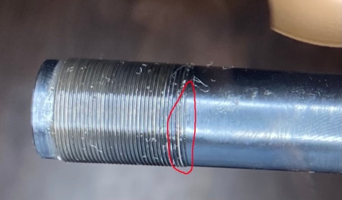

Along with the 10" original barrel I purchased from Stan, I also purchased one of the CZ 8" .445 barrels thanks to Genny. The barrel arrived today and the barrel will not screw in far enough to have the proper cylinder-to-barrel gap. Has anyone else had this problem?

Maybe post some pics. I just checked all my new barrels 2 out of the 4 it got hard to screw them in the last few turns I had to really put some force to get them to screw in the last turn so maybe try that. Also my 8 inch is a stainless inner barrel even though the shroud is blue. She had told me they were out of blue 8 inch blue inner barrel so I took what I  could get it was one of the barrels that was harder to screw in the last turn.

I tried that and it would not screw in far enough. I looked at it under the magnifying lamp and it looks like it's not threaded far enough up the barrel (see pic).

I guess you will have to give Genny a call. I think they just use 44 magnun barrels now for 445 also but not sure. hopefully she has another one in stock. I have looked at the new CZ barrels and my 44 mag barrels look exactly the same as the 445 barrels! I have them right here they look the same.

I sent her an email with the pic attached. I have her phone number somewhere, but I couldn't find it.

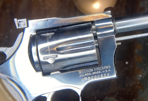

OK, DUH, it's not the barrel, there is something wrong with the frame. There is plenty of threading on the new 8" barrel, it just stops about 1&1/2 to 2 turns short of being able to set the proper gap (see pic). I tried the 8" barrel in my 44 magnum and it screws in all the way with no problem. I also took the .445 6" barrel that came with it and tried it in my 44 magnum. It screwed in fine until I got close to the proper gap, and then it was somewhat difficult to turn, but it did go all the way in with a little bit of effort and I set the gap with no problem. I can probably force the 8" barrel into the 445 frame, but I'm concerned about damaging the threads.

I've come to the conclusion that it's not the barrel. I tried my 6" 44 magnum barrel and it won't screw all the way down to the proper gap either. When the 10" barrel I bought from Stan arrives, I'll have another data point to check.

Hmmm you just bought that gun correct? I hope it's an easy quirky fix. You don't want to be added to the Stan Dan Club of every gun yo buy has a problem. So you have another gun you can troubleshoot that's good anyway. I have problems crop up where I have to go back to the past to figure out what U have done. One of them is I would try to run the gun in single/double action and it would have problems rotating and it always comes back to me having the barrel installed wrong. Pull the gap tool to early or another thing that crops up is when your tightening your barrel nut and it does not turn freely so as you tighten it your screwing the barrel in to tight and the gap is to close. It can be frustrating! good luck i'm sure rhe experts here will help you get it fixed or figure out what's wrong!
