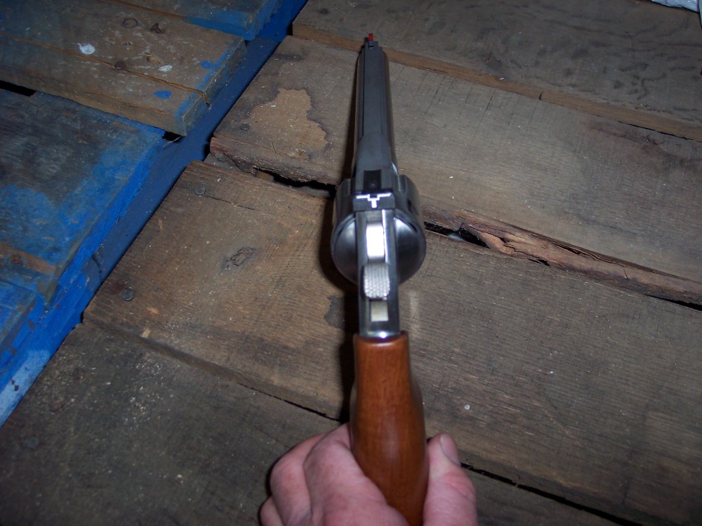

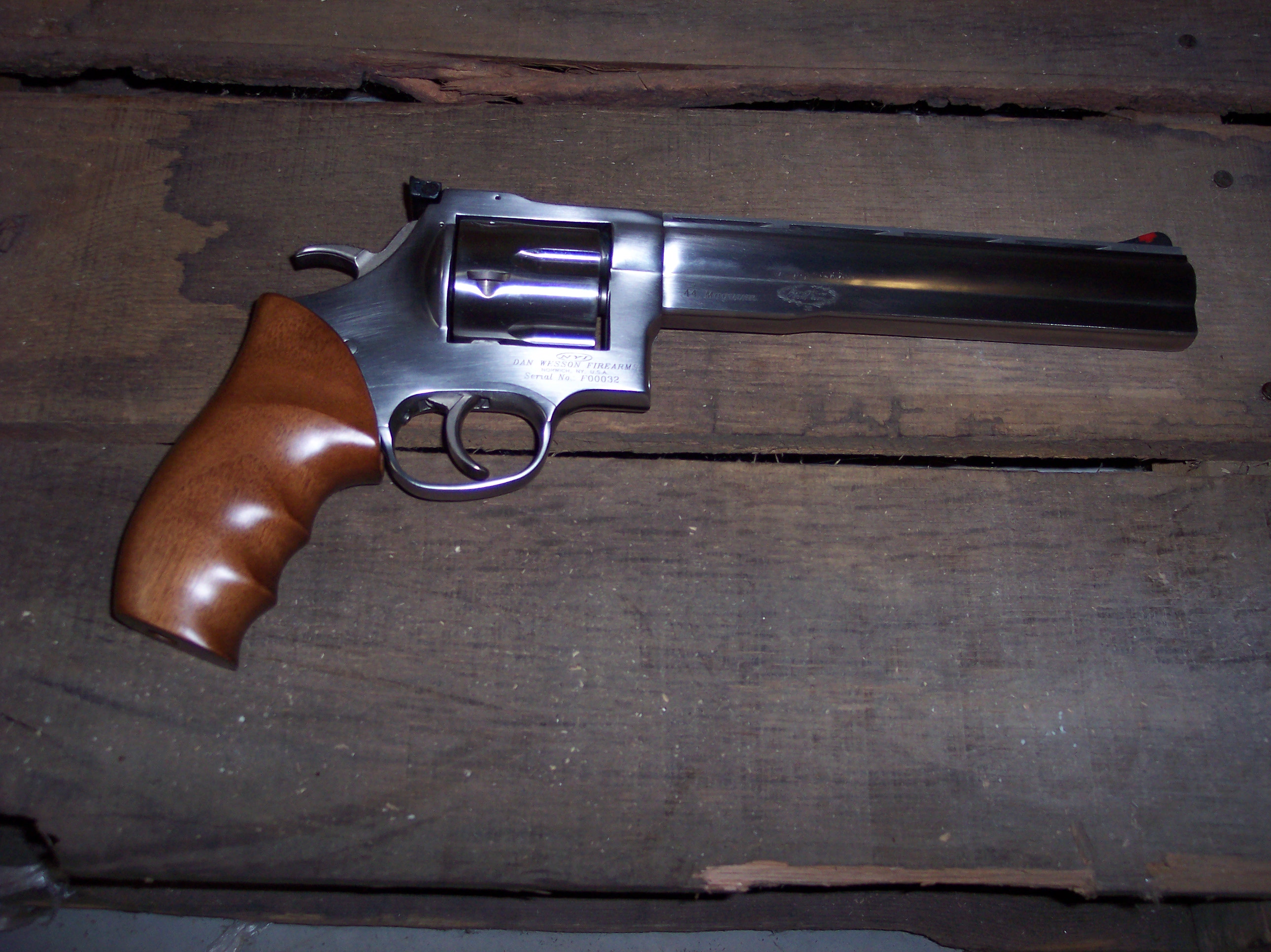

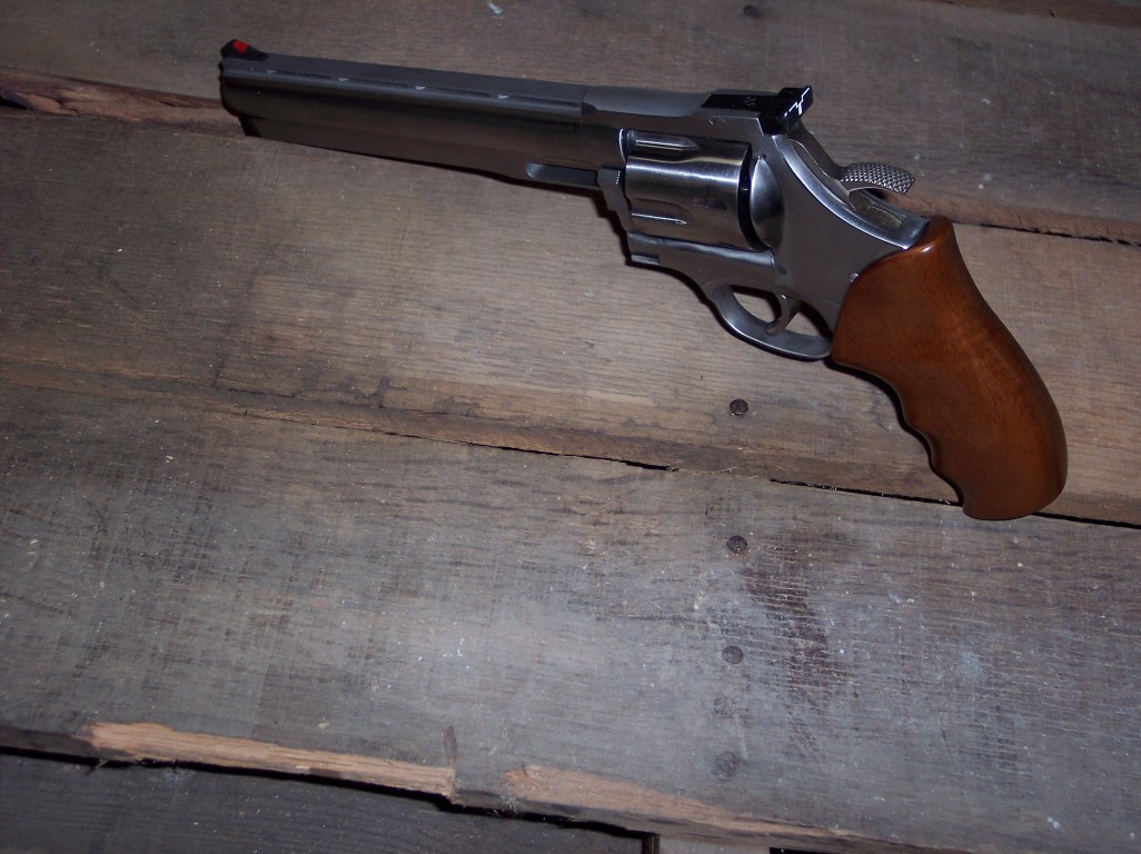

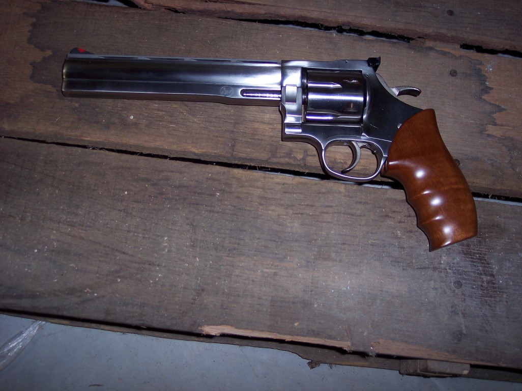

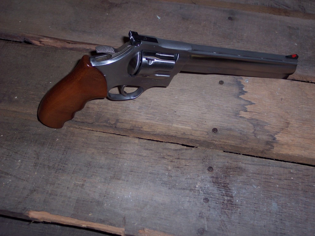

Here are some quick pics.  Its been ugly outside today so had to shoot these in the basement.
