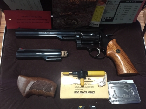

Took some dealing but was finally able to land the 357 Super Mag Pac.  Has proper green label on the side of the case and came with extra 6” and 8” Barrel tubes.  Not sure the combat grip is original.
20D6A829-91EC-48C4-B660-DF1078C2F5A6.jpegImage Enlarger
June 15, 2018 - 5:14 pm
Very Nice!drool
I think you are right about the grip. It is not a DW Combat grip. I think it is aftermarket, maybe Eagle. Someone else may know for sure.
