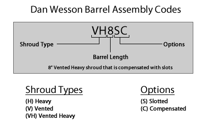

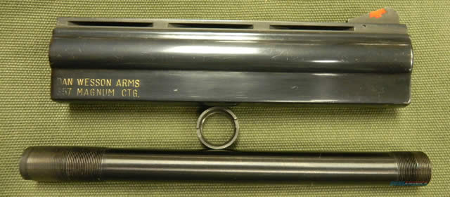

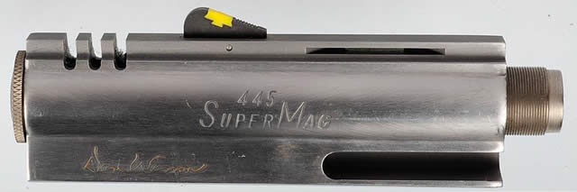

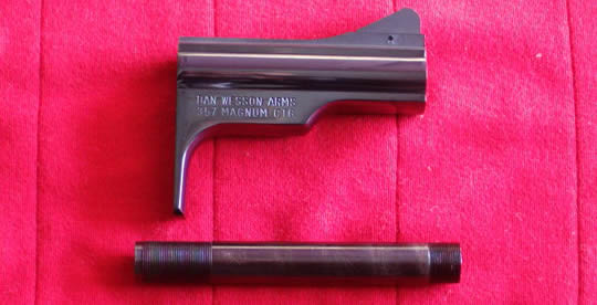

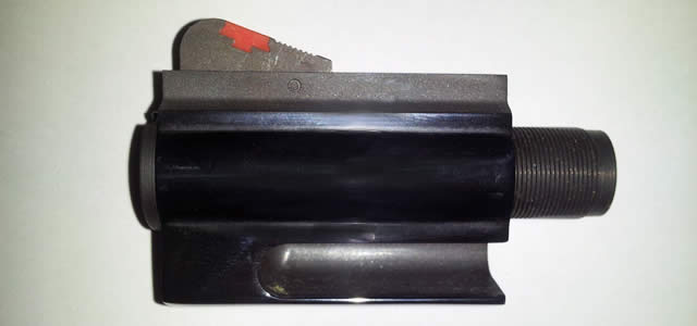

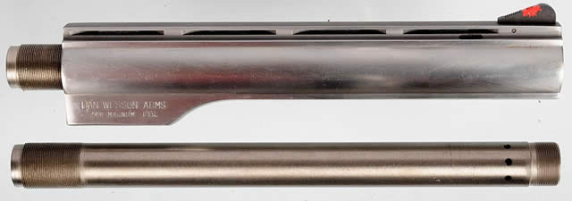

Barrel Configurations
Because of the Dan Wesson interchangeable barrel system, when the guns were sold, the barrel size and type was usually part of the model designation. Obviously this would change if the user changed the barrel, but it is still an interesting part of the Dan Wesson equation.
  • Standard barrels having the solid rib without the heavy underlug were usually designated by the barrel length alone. For example, as per the information posted above, a 357 magnum with adjustable sights is a model 15. The same gun with the standard 8” barrel becomes a model 15-8
  • Barrels with the vent rib get a V prefix. So our model 15 with an 8” vent rib barrel becomes a model 15-V8
  • The Heavy underlug adds an H to the designation, a Heavy vent rib 8” equipped gun becomes a model 15-VH8
  • The slots cut on some of the silhouette shrouds add an S to the end. The most common was the 357 Supermag model 40 (or 740 stainless) So a model 740 stainless with the 8” vent rib and slotted shroud is a model 740-V8S.  Yes, there were even some heavy underlug slotted guns, then a 740 vent rib, heavy underlug, slotted shroud gun is a model 740-VH8S
In summary barrel configurations are:
  • Early Pork Chop Shroud
  • Standard
    Standard.jpgImage Enlarger
  • V = Vent Rib (The example below also has Power Ports)
    Vented.jpgImage Enlarger
  • H = Heavy Underlug
    Heavy.jpgImage Enlarger
  • VH = Vent Heavy Underlug
    VentHeavy.jpgImage Enlarger

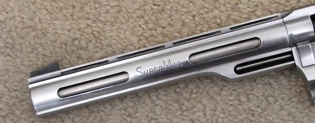

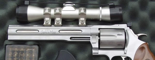

  • S = Slotted Shroud
    VentSlotted.jpgImage Enlarger
    VentHeavySlotted.jpgImage Enlarger

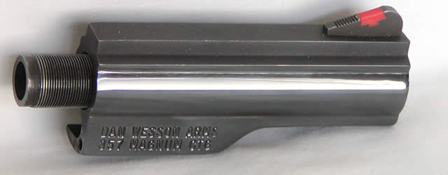

  • C = Compensated Shroud
    Compensated.jpgImage Enlarger
Barrels were available in the following standard lengths:
  • 2"
  • 4"
  • 6"
  • 8"
  • 10"
  • 12"
  • 15"
Also note the barrel length is the actual length of the barrel, from the forcing cone to the muzzle crown. The shroud length is obviously less because of the area the barrel screws through the frame.
The following image should be of some help in deciphering this information:

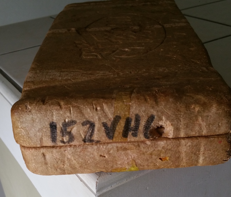

I can't think of another model, but I took a pic of my original styro box from 1978 and the dealer markings. My factory serial label is long gone from it and it may not mean anything but I thought I would put it out there.
20150312_115953-800x681-1.jpgImage Enlarger
20150312_115953-800x681.jpgImage Enlarger
I can't think of another model. I do have a pic I just took of my original styro case. This is from 1978 the dealer markings , of coarse the factory label is long gone now.. May not mean anything, but I had seen these type marks on other boxes.

Jody:
Please excuse my dyslexia if I read your post wrong, but I think you missed the compensated BA designation.
I have a V8SC for my 445SM (I think: I'm in CA right now meeting my new grand daughter, so I can't look in the safe to be sure).
But I do remember (since it's a recent purchase) that I have a VH4C BA for my 7460.
March 12, 2015 - 1:45 pm
zoommb said
Jody:
You are correct!
