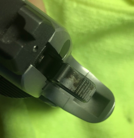

I picked this VBob up news from my LGS this summer, they ordered it from Davidsons....
I have concealed carried this gun quite a bit, and the other day noticed quite a bit of rust on the hammer.  Naturally, I sort of freaked out, it being a $1700+ gun that I traded 4 quality firearms to get, including a Walther PPK/S that I concelaed carried for a year without any blemishes.
I emailed Keith, and I have to tell you guys, I am really upset by his response.
"This is a tool steel part, which means High carbon.  Sweat will make it rust/blue.  It can be reblasted to make it white again but with constant carry is likely to rust again.  We could also send it out to be hot blued, or save some money by buffing it and cold blueing it yourself."
I cannot fathom that DW would make a near $1800 concealed carry gun with a hammer that is simply designed to rust out like an old garden rake, and that someone at DW said "yeah, that's ok."  I've been CCWing since 1998 and I've never, ever had one of my guns rust.  Glock, HK, SW, Walther, FNS, Remington.  Not a one of those guns cost me even half what the DW did.  I have less than 100 rounds through this gun.
I honestly might just take it back to my LGS, have then send it back to Davidsons and be done with it, and use the money to get something that is REALLY designed for this.

Well, obviously I am frustrated that a carry gun would come with any part that will rust with normal use... exponentially so when the gun comes at that price point, and is otherwise fantastic.
I think my frustration is partially at the response, which indicates that a fix will be on my dime, and partially in DW letting a gun go out the door with this known flaw as opposed to engineering a fix.
I am not a gunsmith or comfortable with removing the hammer myself, so I would have to pay a gunsmith to do so, even if I did the cold bluing myself.
But that brings me back to:  Why are they shipping guns for concealed carry with a known rust issue when used as intended?  To me, that IS them installing a substandard part.
I'm frankly embarassed to even bring it back to the LGS because I am going to get such a razzing from the Glock (we put ours in the dishwasher to clean them) and Sig crowds that dominate that space.  And I have no good comeback to "so your $1700 gun is rusty after 4 months?  You could have bought 3 Glock 19s for that much money..."
You know how it goes.  It decimates my pride in ownership.
This will also be the first firearm I've ever had to to send back for service.  I'm just really dissapointed, is the long and short of it.

"All of our hammers, sears and disconnects are machined out of tool steel, just like any gun you would get from Wilson, Night Hawk, Les Baer or Ed Brown.  Unlike the MIM parts you find in Remington, Springfield, Kimber, Ruger, S&W, SIG, Etc.
Tool steel is the absolute best material for a nice crisp, clean trigger pull that will last a lifetime.
Every person is different and has a different chemical makeup.  I have carried a Tool steel hammer for years and never had rust or tarnish but that is me.  I have seen other people touch stainless and make it rust within 24 hours.  Yours is more of a tarnish, not really a pitting rust."
Again, still miles away from what I would hope would be the response given how much I spent on this gun.
I know a good deal about steel being a knife collector, and I know they could have easily made just as precise a part out of a higher quality steel that would resist rust.  High carbon steel is an upgrade from MIM but be it 1095, 1060, O1, A2, etc are fair, but they could have used D2, or better yet, since they are a few miles from Crucible in Syracuse, they could have made them out of one of their CPM metals like M4, or 3V, etc.

I’m a bit curious as to the location of the discoloration on the hammer.  Is it only on top (as seen in the pic) where your thumbs makes contact?
HalM
Forum Posts: 8
October 22, 2017
October 31, 2017 - 12:27 pm
No, it is all over, down in the little groves, etc.  Everywhere.  Keith calls it a patina, but to me it looks like what happens to the undercarriage of a car in this area after one winter.  The rust grabs on and spreads everywhere.
My fear:  If I have rust all over the part that I can see and lube, what is happening internally that I can't get to?
That photo was taken AFTER I used CLP and tried to clean it up, too... it looked much worse before that.
