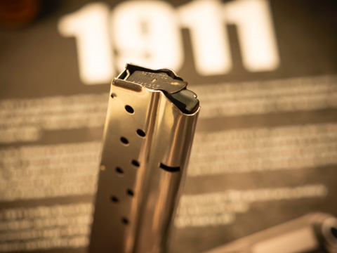

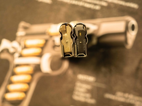

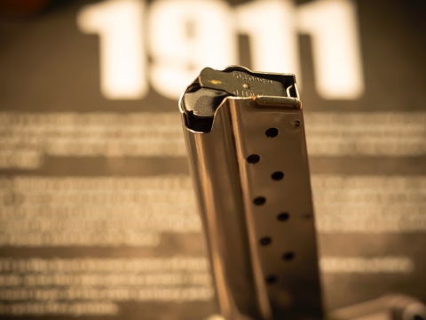

Here's a few, thanks.
20210108-P1081713.jpgImage Enlarger
20210108-P1081714.jpgImage Enlarger
20210108-P1081715.jpgImage Enlarger
20210108-P1081716.jpgImage Enlarger
Forum Posts: 1236
January 8, 2021 - 10:27 pm
Looks like it was just barely hitting on the front edge of the follower but it looks like there is a little notch in the follower in front of it. Maybe look for one that has a full radius without that notch and that would give more contact area. I will check my 9mm mags tomorrow and let you know what their profile looks like. If it is new you can call DW and tell them about it they may issue a call tag if they think it is non mag related i.e. fit new slide stop or mag release. Just FYI as their move to KC has slowed response and turnaround times.

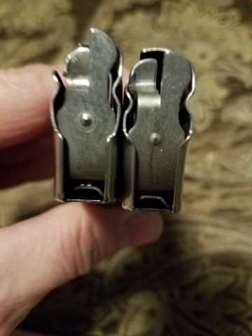

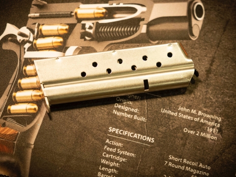

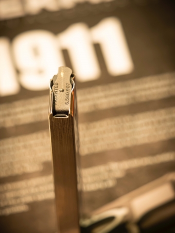

Here are two of mine, both factory DW. Followers are different than yours. See if you can borrow someone's that looks like this follower maybe it will make the difference with locking back.1-9-010.jpgImage Enlarger

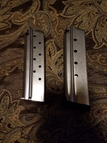

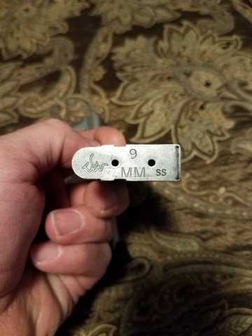

Here's my mags. The one on the left is what came with the V-bob and the one on the right is the Checkmate. It's obvious the mag that came with the pistol isn't a Checkmate. It looks more like the one you have.
I hope Keith see's this post and informs me what mag company I can purchase extra mags from.
Thanks again for your help, much appreciated!20210111-P1111734.jpgImage Enlarger
Forum Posts: 1236
January 11, 2021 - 9:31 pm
I'm almost 100% sure my two are Metalforms. Metalform's don't have the pinch welds along the back of the mag that holds the spacer in. I've only had one  problem with mine since you can get a little lateral movement in them. And if there was a little extra meat taken off the slide stop when fitted and the follower shifts a little towards the ejection port side it could miss the lug on the SS. I put a flat blade screwdriver between the high and low spots in the split area of the follower and twisted the blade slightly to open the split slightly. This will help get the part that pushes up the SS closer to that side of the magazine helping with the engagement on the lug. A little adjustment at a time or you will have binding issues with the follower, it doesn't take much.
Forum Posts: 1236
January 11, 2021 - 9:43 pm
If you can get the follower out of the mag on the right and slightly compress the follower to make less of an angle it will allow the follower to rise higher in the mag which will let the follower base to rise higher in turn will push up more on the SS and help to lock back. You probably won't be able to do it with just your fingers unless you have strong hands, a pair of pliers is usually enough. Just do a little bending at a time it doesn't take much to make a difference.  These type of followers usually don't have lateral movement so I would assume it isn't rising up high enough to fully push up the SS. If neither remedy works it could be that to much material was removed from the SS when it was fitted in which case you would need another one fitted or keep trying different mags until you find ones that work all the time.
