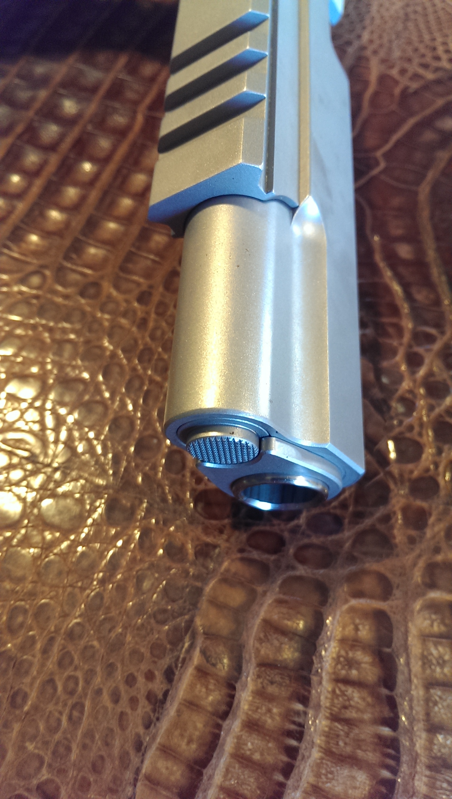

These are the photos of the problems with my Specialist.IMAG1083-copy.jpgImage Enlarger

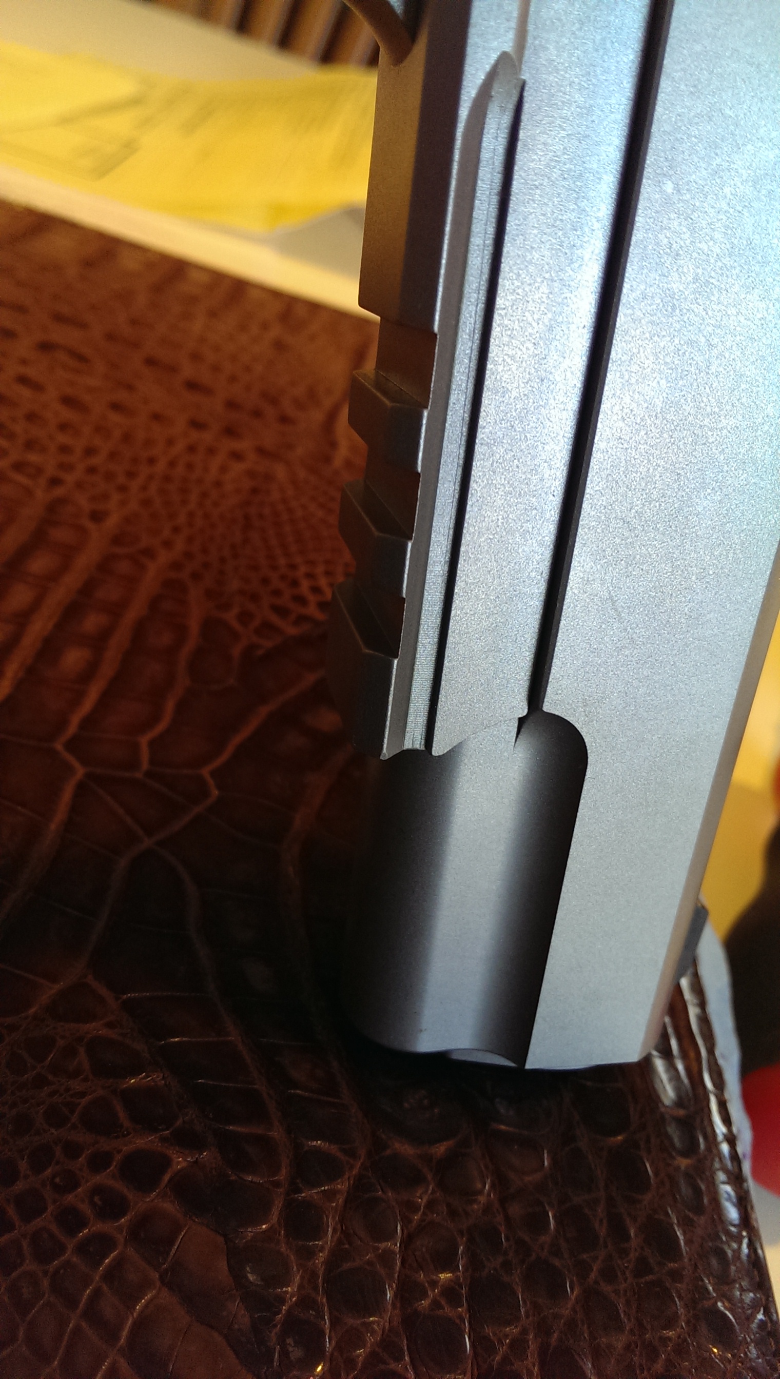

 IMAG1086-copy.jpgImage Enlarger

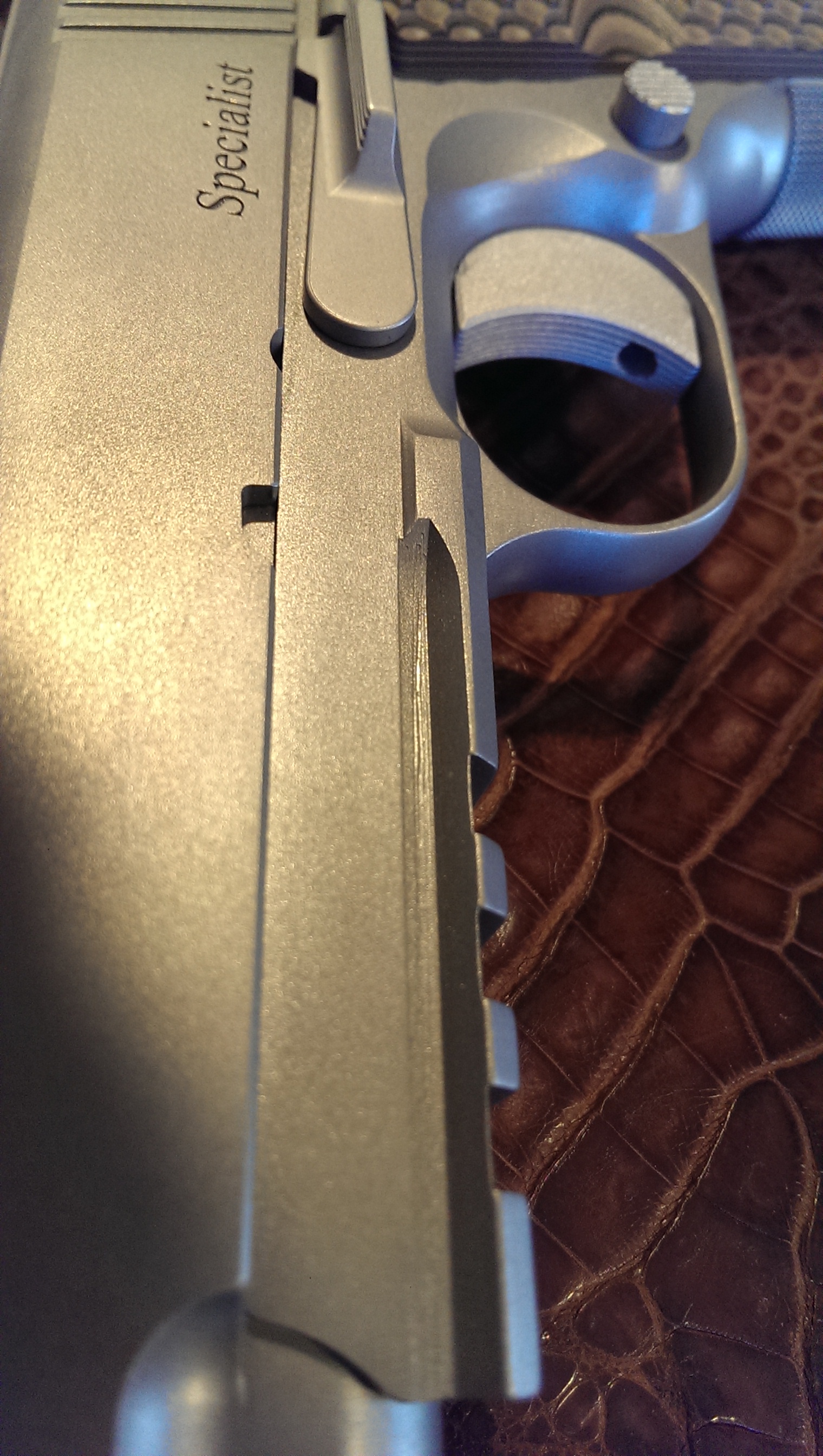

 IMAG1088-copy.jpgImage Enlarger

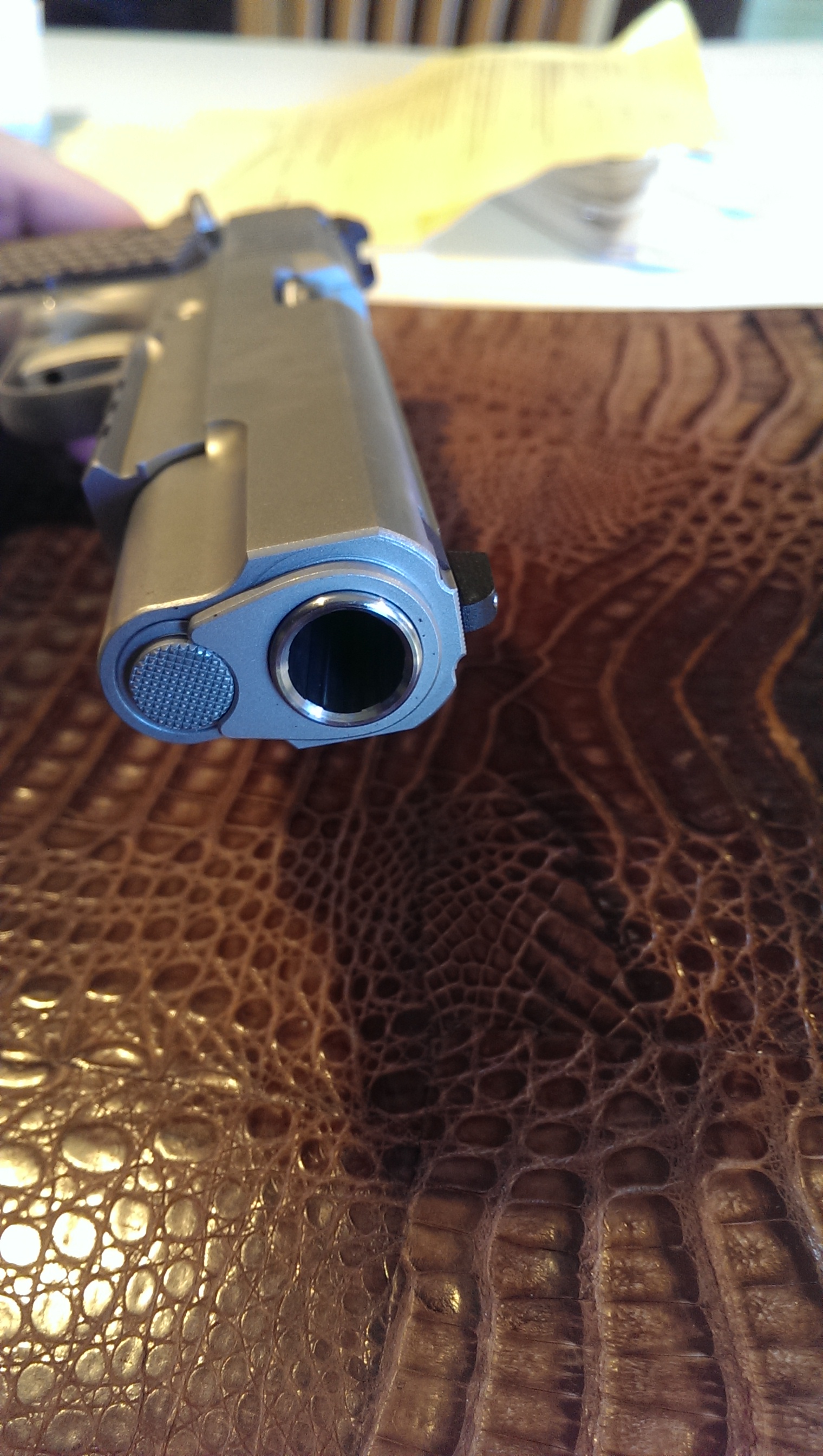

 IMAG1091-copy.jpgImage Enlarger

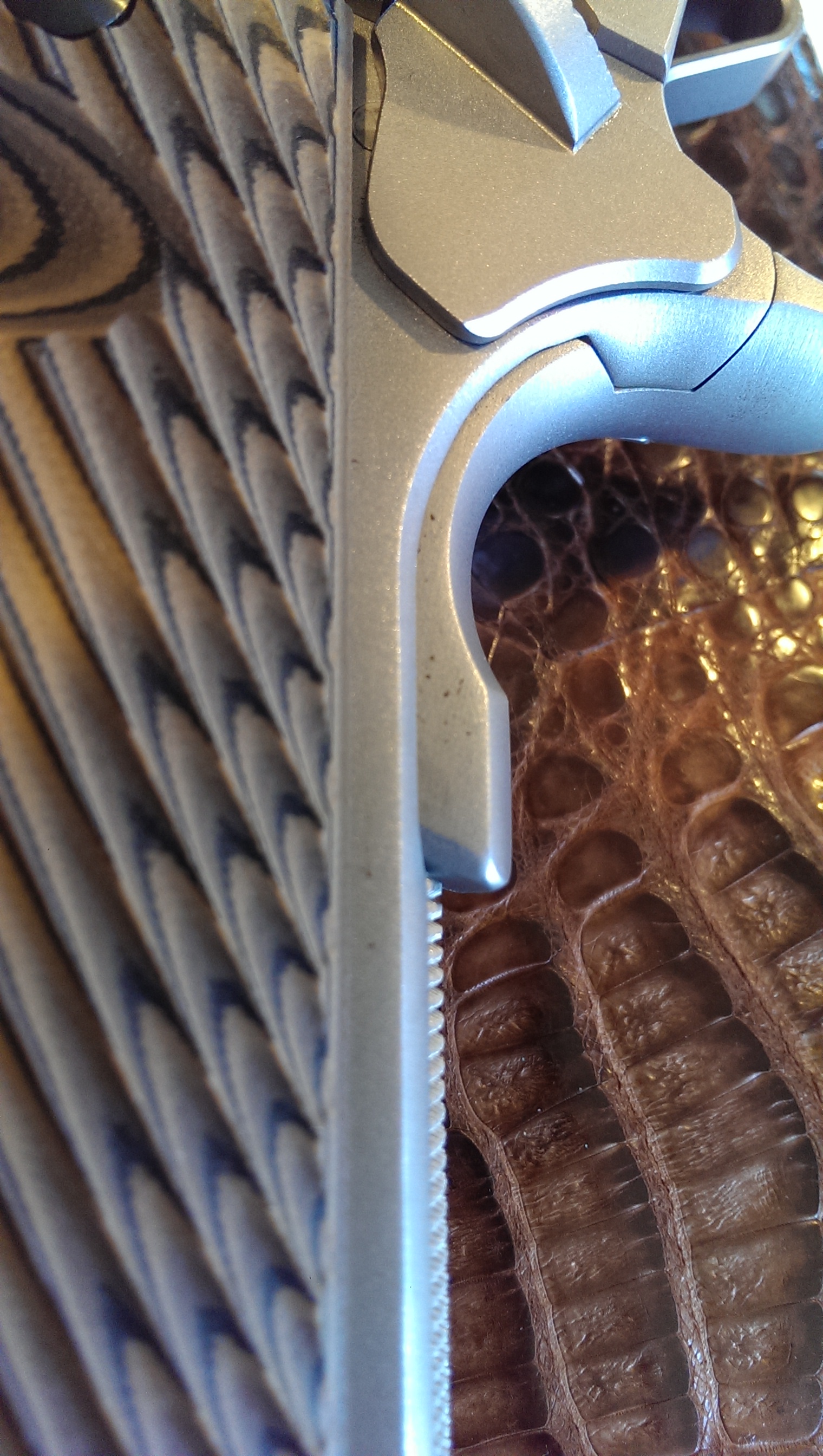

 IMAG1092-copy.jpgImage Enlarger

I've never had a stainless gun with that much of a mat of a finish, so I have no experience per se but those spots don't look like rust to me, but rather spots on top of the finish (they're too perfectly round, like paint splatter).  Have you tried wiping the finish with a CLP or even Rem oil to see if they lift off?  I can definitely see the marks on the rail, looks like someone mounted something on it and dragged it off, but before the matt finish was applied???  Good luck with resolution.

They are clearly rust, and most obvious on the inside of the plug.  Won't come off with Gibbs, fingernails, etc.  The scratches in the rail grooves are in the steel.  They almost have to be from the machining process.  No optic would do that and it was still wrapped in the plastic, NIB from osagecountyguns, a major gunbroker dealer.
The surface of the two troughs do not look alike either.  Maybe cutting 1913 rails into steel is not something they have a lot of experience with, at least not on a 1911 frame.
January 6, 2015 - 7:43 pm
It's rust.  Iron on the surface of stainless will show up as tiny rust spots and will pit the metal.  The line in the rail slots are from the mill cutter - they won't be coming out.  Here's the link to the Warranty Service at DW

First that is really a sweet 1911cool
The rust spots to me are odd and appear superficial as if something adhered to the finish rather than within the finish if that makes sense? In the car business we frequently have people complain about little rust dots on their white cars, actually they are rust dots but not from the finish but from the suspended metallic brake dust particles that adhere to the finish and corrode. Yours look a lot like that to me. In now way am I suggesting that it can't be from the finish but I wonder if by chance with a closer look you might see a tiny particle on top of the finish rather than imbedded in it?? The gun is stainless is the coating/finish stainless or like a Cerakote?
I wonder if there was any metallic dust in the packing or foam case your gun was in from the factory?
I can relate to your irritation on the finish work showing the machining marks on the slide rail mount. Likely if they happened after the fact they likely may have showed corrosion? I too had similar issues with my S&W E Series 1911 and had to send it back, not the rust issue but finish blems on the slide.

Keith at DW says  "There is really no way for us to totally eliminate machine marks in this area. We may be able to soften them for you."  I think they are clearly blemishes but may have to send to a real custom shop to be cleaned up to my satisfaction.  I will probably end up sending to Robar for minor work and NP3+  because I have never had a stainless pistol that rusted.  I have an 18 year old Kimber stainless with zero corrosion of any kind.  I can't wrap my head around the problems with this new pistol.  I will never do a Form 4473 on a transfer again before an in-depth inspection.  Lesson learned.

They say no problem with the rust.  Will re-blast it.  Apparently glass medium dirty with steel or iron particles can leave rust if left on the surface.  It sounds like the gun was not thoroughly cleaned of metal particles after the glass-blasting.
I am getting mixed messages on the machine marks on the rail.  I will send it back for repair and see if they can restore my faith in them.  I just wish they would replace it or at least say "it will be perfect when it comes back, no worries mate."  I am missing out on a great deal on a Nighthawk I love because I bought this Dan Wesson.
