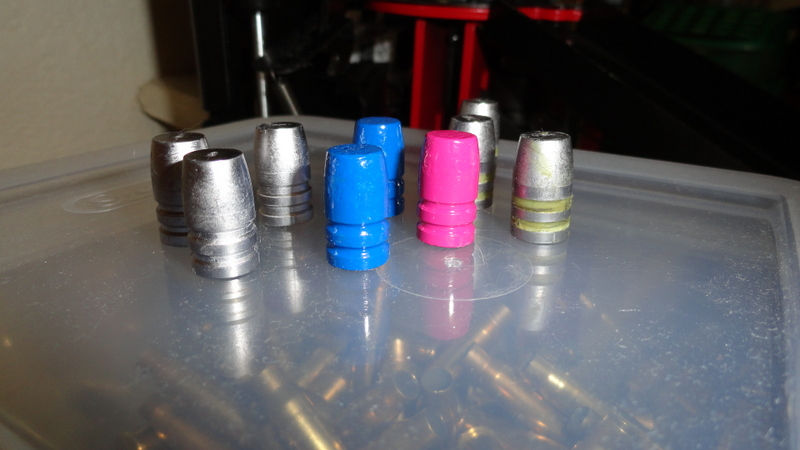

Don, Are you powder coating yourself?  I just finished coating a small batch of 10mm last night.  I have a 220gr WNFP boolit and I pour my own- usually COWW, which ends up at 12bhn.  I heat treated these in the oven a few days ago and now they are at 22bhn.
Not running a 38 Super for load comparisons, actually...I don't have anything in 38 Super, hmmm....  where's my wallet???

OK I give, I realize I am behind the times so I can take the embarassed. What is the coating for? Does it replace the lube or the jacket? Or is it just for looks? Last gun show I went to some guys were selling ammo with coated bullets that looked like they were dipped in mule snot. Someone bring a out of touch guy up to date.
Ingorant in Georgia   AKA   LB

The coating replaces the lube, or so Ron told me in another post. I'm not familiar with the process either. We always get the word last down here, you know that. I blame it on the movie "Deliverance".

Yep- replaces lube.  The Aussies have been doing it for years...  no more trying to figure out which lube for what velocity and how many grooves to lube in order to make it to the end of the barrel or avoid the "lube star" at the muzzle.  No copper to clean and no leading to moderate velocities.  Plus, it's just something else to dittle with...  I'm currently dry tumbling and don't spray. That's why the unsized ogive to nose area looks a bit lumpy...
