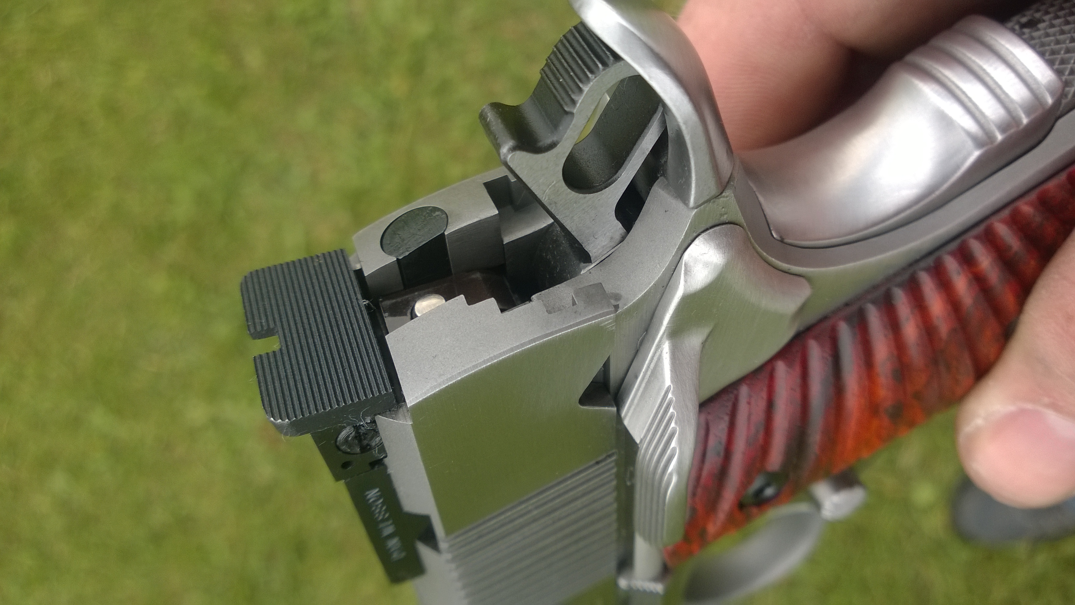

I tore the 1911 down all the way to the extractor, cleaned re-assembled and shot it again today. It still has the same issues. I'm using Winchester white box FMJ 230 grain and Remington umc 230 FMJ. I used them in the two magazines that came with jt as well as 2 new ones purchased from Dan Wesson.
I put the full magazine in. Rack the slide back and it comes forward all the way except for about an 1/8th of an inch. I took a photo of it in this position. In this state, it will not fire. When the magazine is dropped out to attempt to remove the jam, the slide is very hard to move back. This happens more times than not. I'm not sure what the issue is with it. Any suggestions?WP_20150629_001.jpgImage Enlarger

Fist thought is that you may have a tight chamber.  Get a box of match 45 ACP and see what happens
It may also be the extractor tension.  Remove the firing pin retainer, firing pin & spring and extractor and (pointed in a safe direction) see if it chambers a round easily. If it does, the extractor may need some work because it isn't allowing the cartridge case rim to slip into the groove behind the hook. There may even be something in there like a piece of pipe cleaner...don't ask.

 Also, is the chamber nice and clean, no powder residue, carbon, lead etc.?  It doesn't take much to keep a round from going full into the chamber.

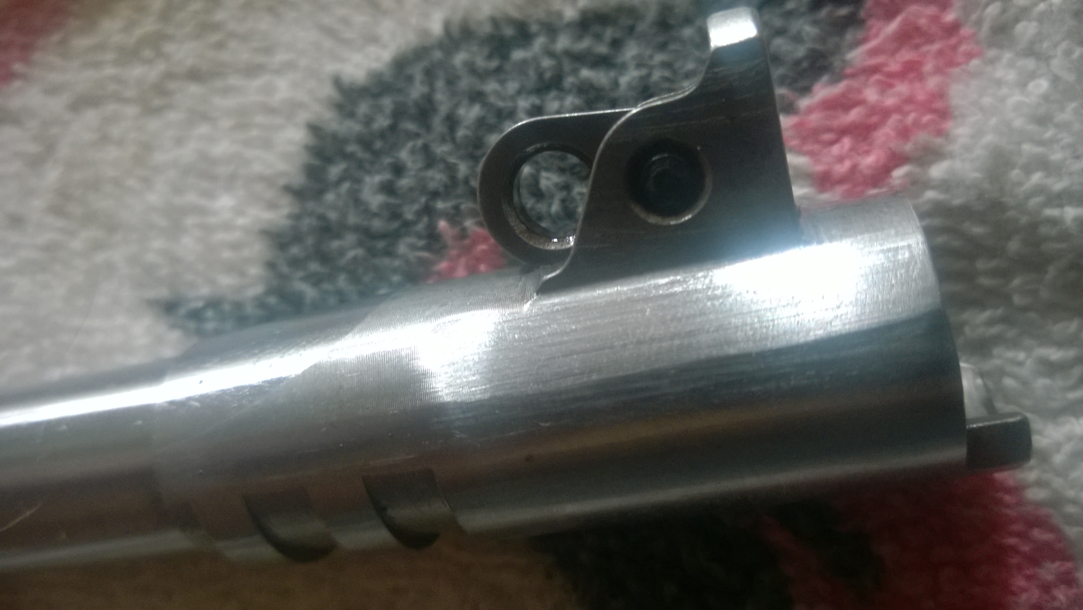

I've never seen any match rounds for sale around here, I will have to try some if I can find them. The gun and barrel is plenty clean, hoping cleaning it would fix the issue. I did not use the DW rail lube, just Remington oil. Upon cleaning the barrel again, I found a spot (see photo) where the barrel is fairly worn on both sides as if its rubbing/catching on something. I oiled this part heavily with Remington oil. It didn't fix it unfortunately
when you sent your wife's pm9 in, did Keith end up having to do any work to it or just use and recommended the DW lube? Is that stuff really work that much better than Remington oil?WP_20150626_013.jpgImage Enlarger

He actually made adjustments to the fit of the slide and the ejector.  He told me that the gun oil I was using was too thin and would cause galling, but not to use slide grease as that would collect dirt and cause premature wear.  For a commercial brand of slide lube he recommended FP-10.

Don't use Rem oil, Hoppes, etc, they are all too light weight.  The Dan Wesson supplied lube is FP-10, MILTEC also works very well.  They are both much heavier oils and will stay put and provide a good lubricating film.  Before you send anything to Keith, clean off the Rem oil and relube with FP-10 and run it wet.  See what that does.  The DW 1911's are much tighter tolerance than say a Ruger and require much more attention to lubrication or they will bind up.  I use FP-10 on all my 1911's and revolvers for that matter.   They seem to run better with it.
