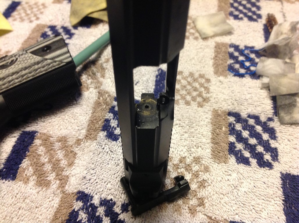

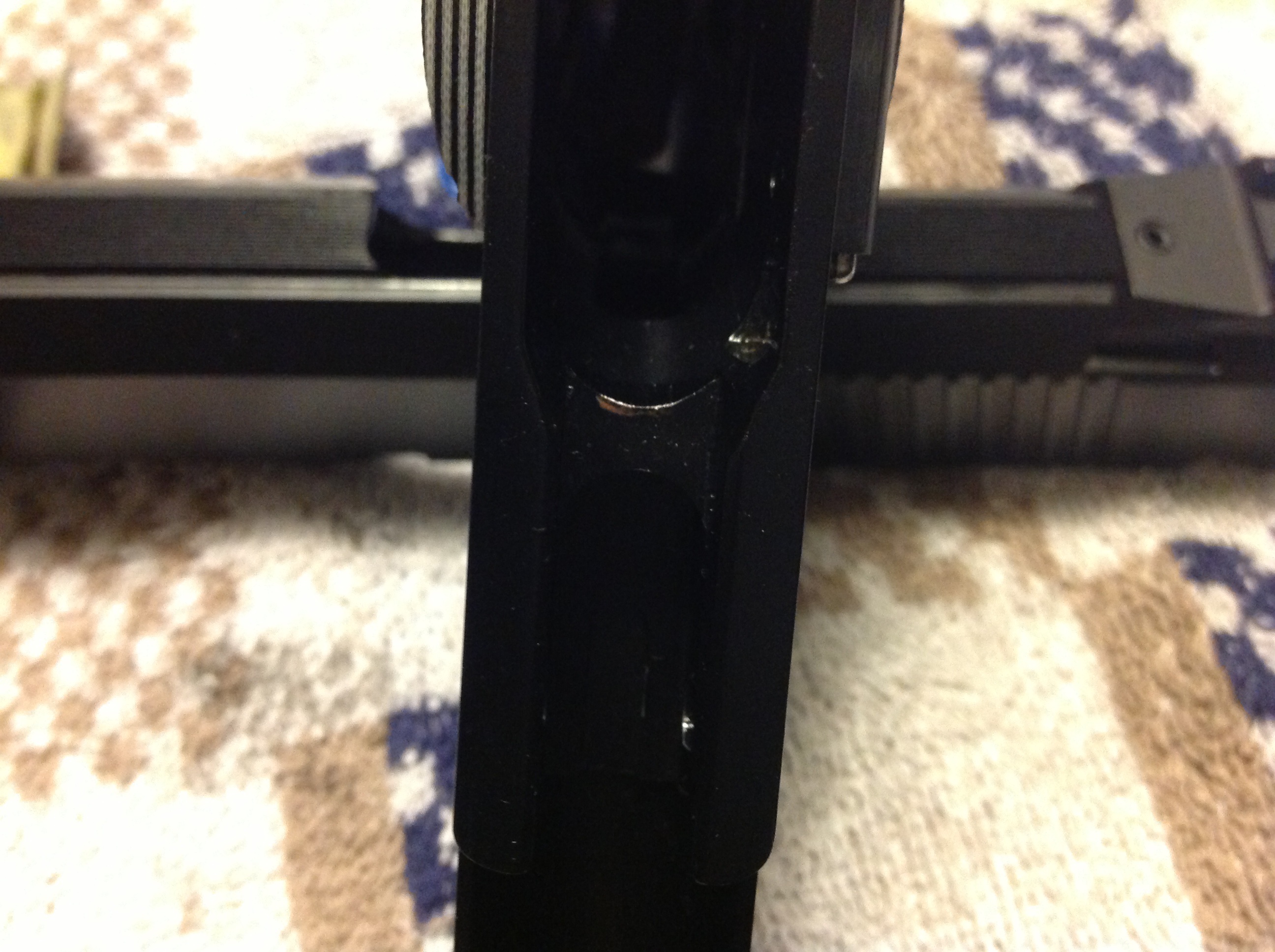

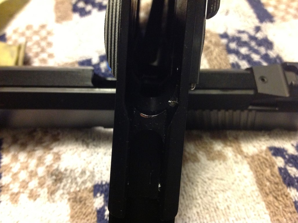

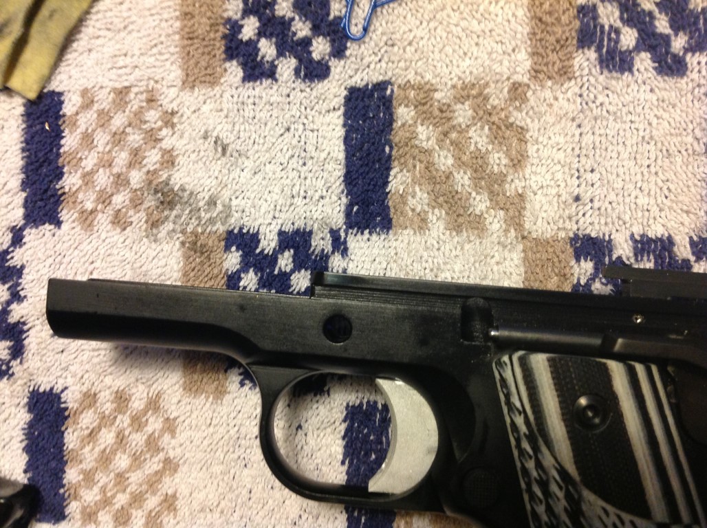

I was expecting wear put didn't know if it his was normal? Especially on the slide and just one side of the frame. I have 300 rds in her with no problems. Thanksimage-2.jpgImage Enlarger

Nothing abnormal- Keep on shooting!

The bottom 2 photos are what I call "brassing", wherein the brass cartridge case rubs against parts of the slide and deposits a small amount of brass thereon. It's not literally "wear" since metal has been added to the slide, and not taken away.
