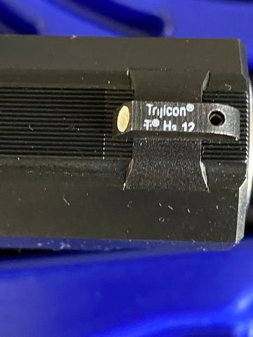

Finally, the Trijicon front blade sight vial is pretty much gone (dark). I have looked on their websight, and don't see an option to repalce, as I have the "Springfield" cut on my sights (pre 2015). I have reached out to Trijicon to see if they respond. Are there other aftermarket tritium sights that could replace the current sights without altering or milling the slide should Trijicon be unable to replace or repair the original sight?

Nice to have ya here.
Any mag in a 1911 officer size is what you want. Checkmate, Metalform, MecGar, Chip McCormick all make a reputable magazine.
DW or Trijicon should be able to change the lamp out in your current sight. Dawson Precision will make a tritium front sight with your specific cut. They changed to a Novak type cut around 2016.
https://dawsonprecision.com/sights-for-springfield-front-tritium-by-dawson-precision/
https://dawsonprecision.com/sights-for-novak-cut-front-tritium-by-dawson-precision/
Call them to order, if you go this route, they are very helpful and will make sure you get the correct front sight. I suggest shooting it for a while first to make sure the blade height will give you POA=POI  and the thickness suits your sight pic as you will be able to change these factors with an all new sight. Hopefully you have some calipers to measure the height and thickness of the sight blade.

Thanks to all for the welcomes and feedback. Couple of updates for ECO fans.
Trijicon can, in fact, replace the lamps in some front sights, so my slide is winging it's way to Wixom a/o today for a replacement lamp. I'm can post a picture of the front blade sight so others who have the same issue can contact Trijicon to verify they can replace your lamp if interested. They will ask you for a picture to do this before you send them the slide.  instead of the original white, it will be green, but I'm fine, and in fact, prefer that. All for a whopping $20, shipping included.

February 1, 2023 - 1:58 pm
Here 'ya go7D20E9E6-38AE-46FB-967C-BC65689EA892.jpgImage Enlarger
February 1, 2023 - 6:10 pm
Glad it worked out.
Couldn't you have just removed the sight blade and sent that instead of the whole slide?
Forum Posts: 1236
February 1, 2023 - 6:48 pm
That was my thinking too.

February 1, 2023 - 7:17 pm
I spoke to an armorer friend who suggested that for $20, it would be smarter & less expensive to send the entire slide, as it would diminish the chance to damage the slide removing and replacing the sight. I don't own a sight tool, and while I've done some minor smithing, I'd hate to screw up a pricey new toy. I'll report back as to how well Trijicon does when it returns.
Forum Posts: 1236
February 1, 2023 - 7:18 pm
Understand completely

February 14, 2023 - 5:02 pm
Update - heard back from Trijicon. $40 to replace front & rear lamps & ship back. Couple'a weeks and a new warranty on the lamps as well. Will post pics when returned.
