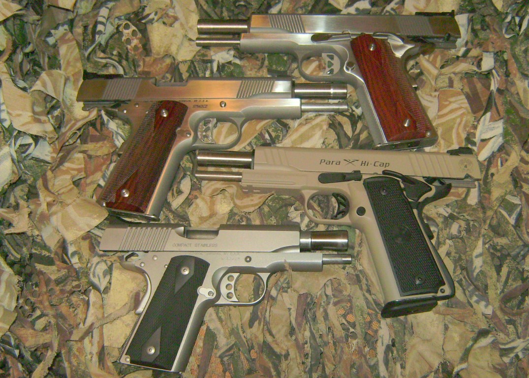

Here's my silly thing. Haven't taken it apart yet to see what all the ruckus is about. Seems to shoot great with it.
