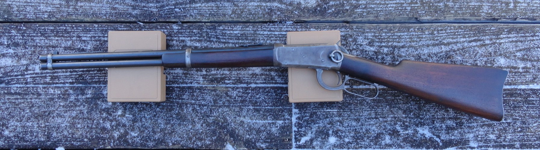

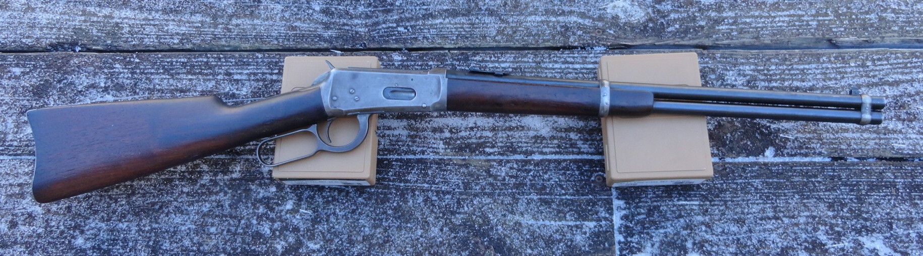

Reloaded some ammo so I could ring some steel on the 4th. I only loaded 10 rounds and will chrono and work out groups on paper at a later date.
Case- Hornady
Bullet- Hornady Interlock, 117 gr. Round Nose
Primer- Win. LRP
Powder- IMR 4320-22gr. and Hodgdon 4198-17.5 gr.
Very pleasant shooting rounds; 10 for 10 on steel at 80 yards, despite a dark bore from BP ammunition from years gone by. This is a 105 yo rifle that shoots!

Ain't it great shooting a firearm with some years on it?

That is a fantastic looking rifle. Did I miss what the caliber was? .32 WCF maybe?

You didn't miss it- I didn't print it, sorry- .25-35 Winchester
