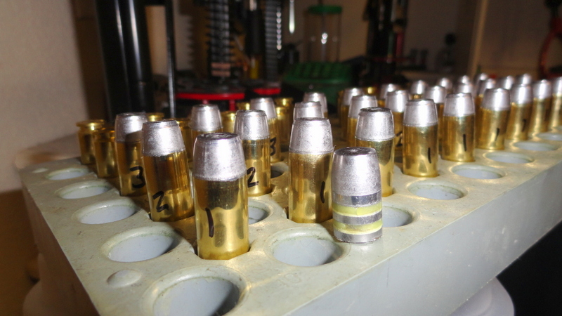

I think I'll just experiment- I'm using my own cast boolits from a Mountain Mold, sized to .401" but it throws at .403" so I can go larger if needed.
DSC01330.JPGImage Enlarger
 Next is to powder coat some and see how they do.

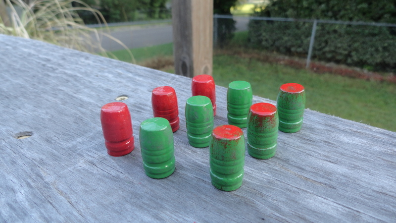

I've been dry-tumble powder coating for a bit.  Works fine and is relatively easy to do.  In fact, a lot easier than lubing but more space and more time are required... .452" zombie slayers:

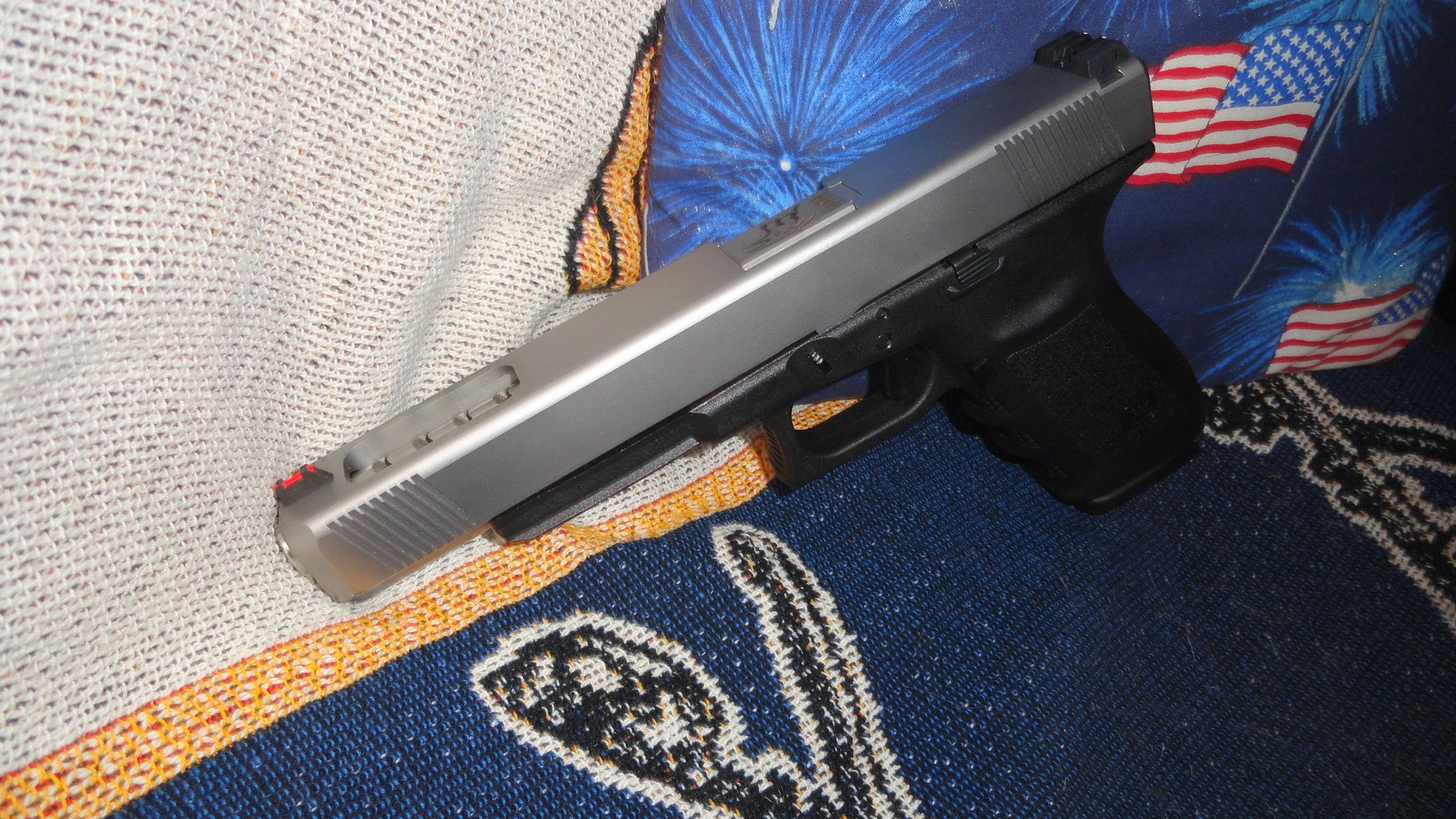

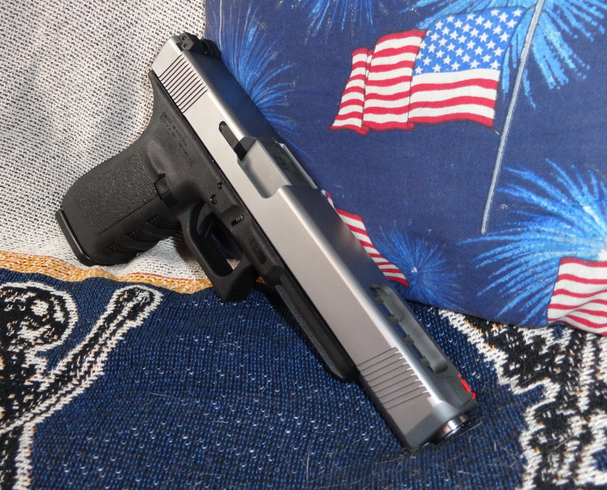

So, tonight I realized I never posted a pic of the glock I put together as mentioned above...2 years too late, but here it is. Haven't harvested the deer or pig yet but it does shoot well....
DSC01480.JPGImage Enlarger
DSC01483.JPGImage Enlarger

Very nice .. I've been Jonesing for a G40 for awhile now and you may have pushed me over the edge. I've got a G17L and love it !
Forum Posts: 4788
January 15, 2017 - 10:10 am
That's pretty sexy looking... I've always said I need to pick up a glock in 10mm...maybe someday.
