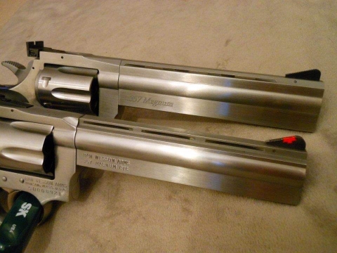

If your shroud looks like the top one that is the new one (2012 and newer) if it’s the bottom that’s the “old” one. Serial numbers for the new 715’s start with RV or DW. They don’t make the porkchop in any variation at all anymore (external or internal nut). 3834.jpegImage Enlarger

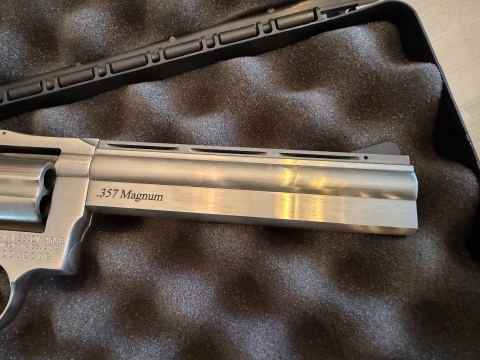

I am a little confused about the barrel shroud though. It doesn't seem to quite exactly match any of the photos in this thread so far. There is no colored element on the blade sight, it's a solid piece of black steel without the separate red element dovetailed in as in the photos here. The vent rib looks like the bottom barrel in superman's photo above, but instead of the rollmark on the right side it has an engraved "357 Magnum" - which is fully engraved, not just an outline like the "new" barrels shown here. I'm presuming there were running changes throughout production but I'm wondering if anyone can confirm or deny what I have.

In regards to the marking on your "Barrel Shroud", that is how DW-CZ is marking the current "BARREL ASSEMBLIES".   The above-pictured outlined-stamped marking and confined to the DW-CZ run of 715s from 2014-2020(?)
dwizum, Yours is the old style frame.

Top V10 (on the gun) is Palmer
VH8 is Norwich (Serva years)
VH6 is Monson
VH4 is EWK
As Scout stated you have a current CZ made Barrel assembly. The outlined markings are for the “new 715” shroud made from 2012 to 2020.
As for your sight it is a standard black one on the CZ barrels many times if you want to change it purchase one on Ebay would be my recommendation user Wesson Firearms is relation to DW and is where I buy sights they have all sorts of colors available.
