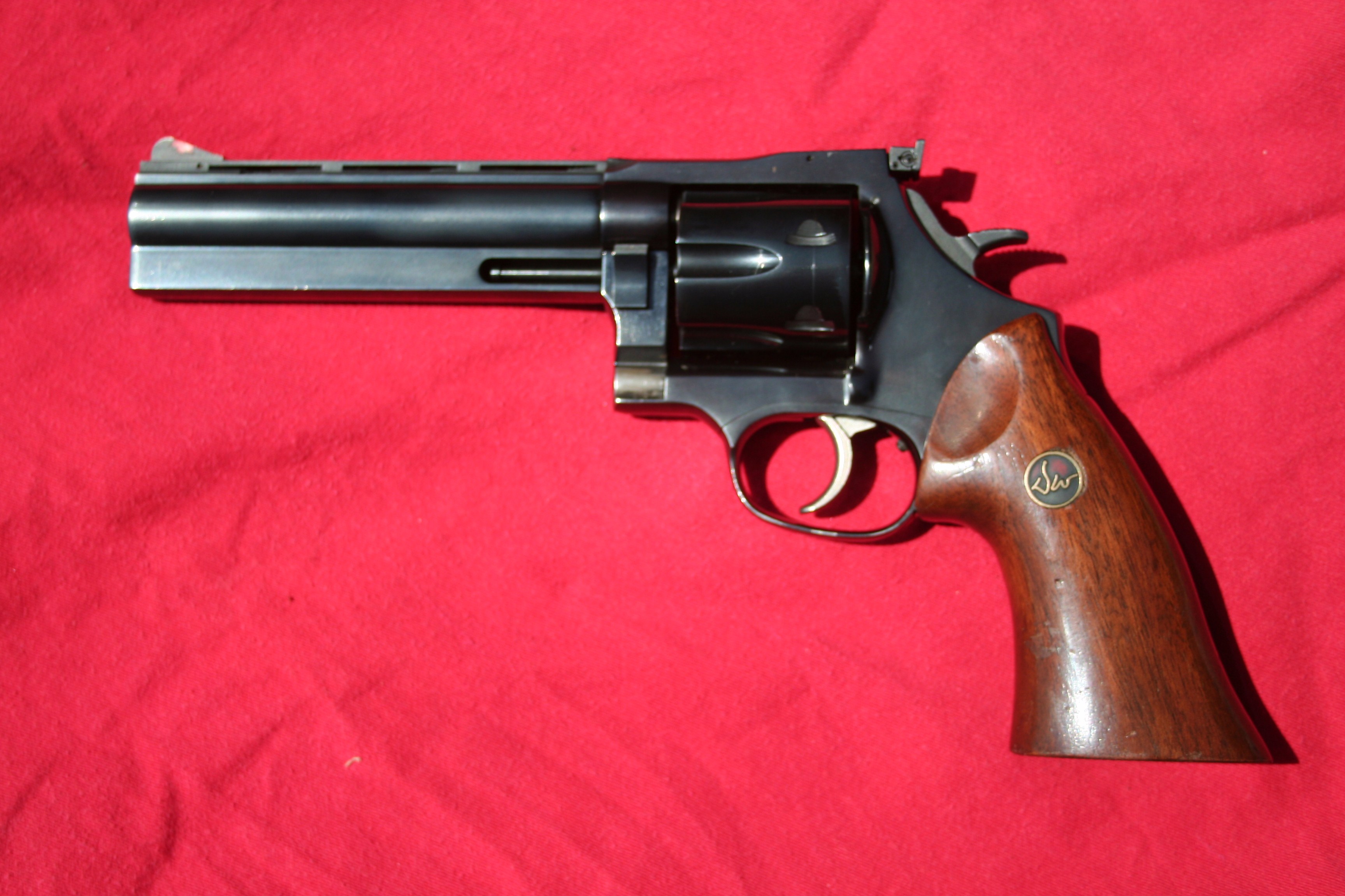

Well I mentioned to my Wife "I think I'll buy myself a gun for my birthday" (65 years young thank you). And she said "OK"!
Madison WI Gunshow and the only Dan Wession is a .44 VH6.
This appears to have been shot very little.

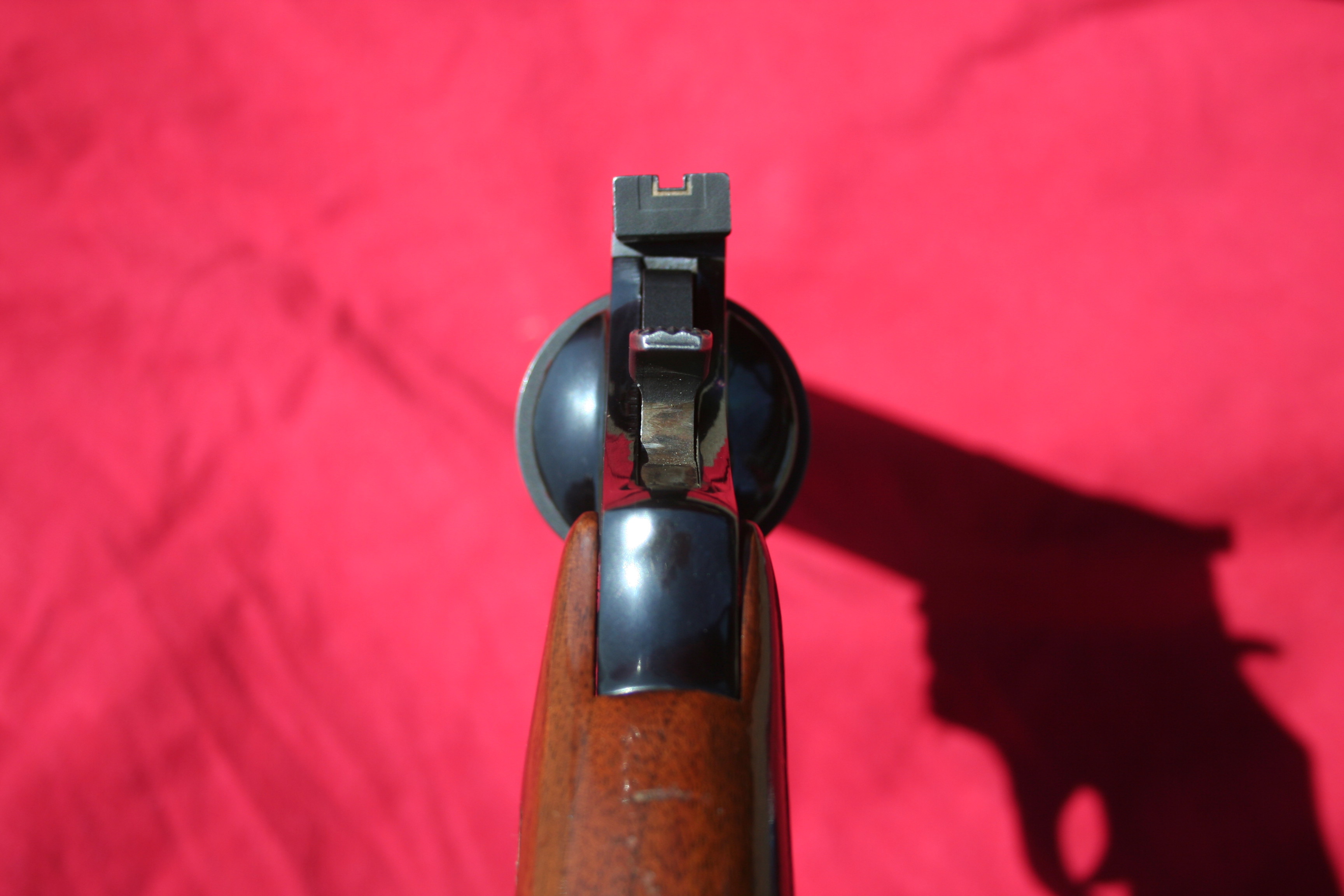

Shot very little but it has been dropped and has a rear sight that is bent, the grip can be trimmed and refinished. It has the ported barrel (ARGH!)
I'm going to look for some ammo now. Wish I had some used brass, that would be easier.

OK! Progress report on the bent rear sight.
The rear sight was removed by punching out the roll pin and the elevation screw was removed. The sight base was visibly bent at the weakest point, which is the hole in the base for the elevation screw. I mounted the sight base in a vise and administered some force with a hammer and an aluminum drift and I wasn't shy it took some force to straighten. Re-installation of roll pin and elevation screw and TaDa. Well only I know it's still a little bent. I have a box of ammo and will see if I can shoot a .44 Mag this weekend.
