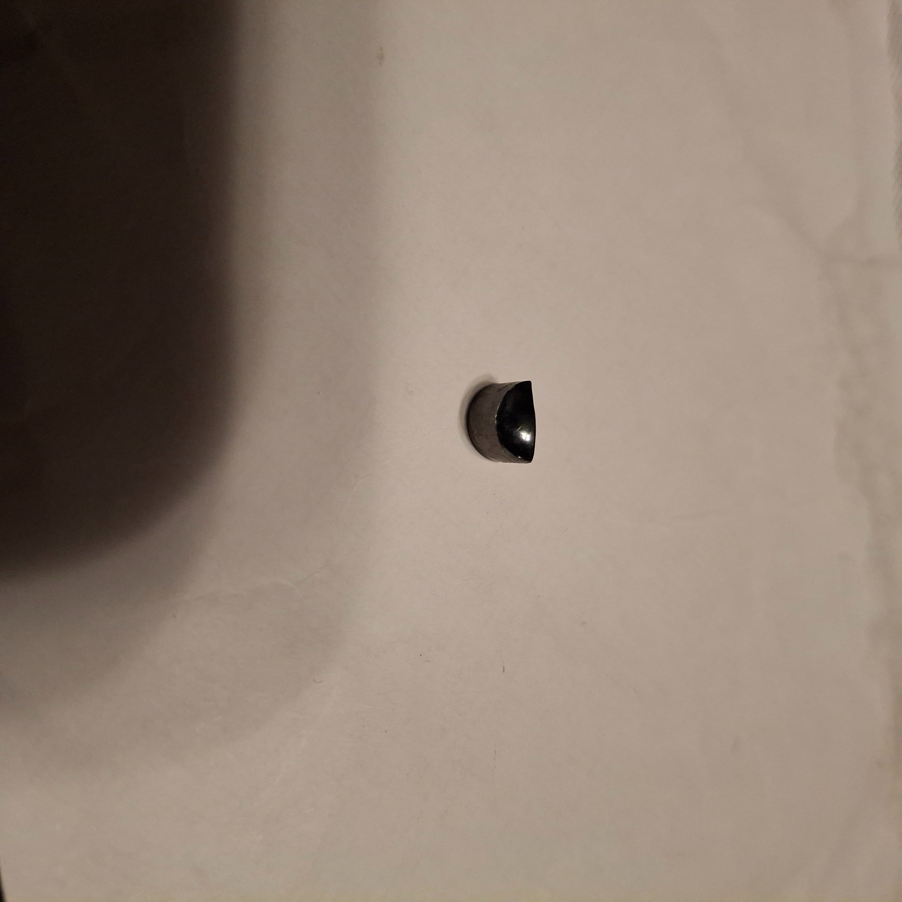

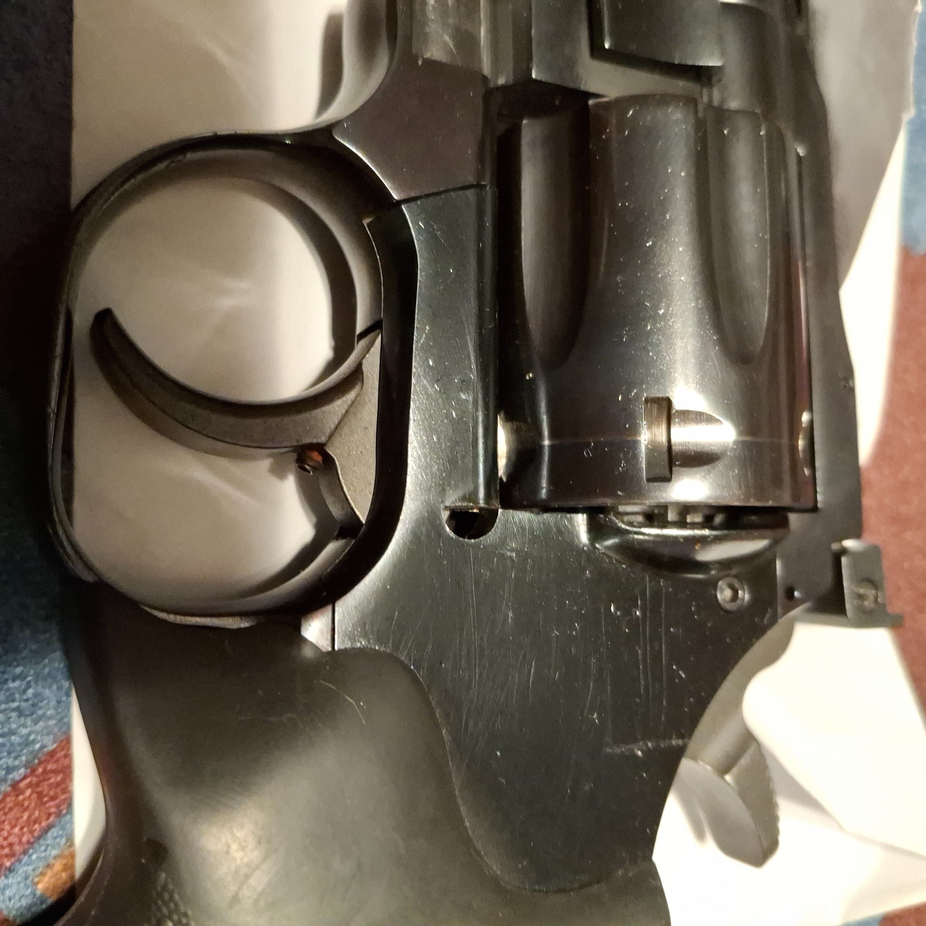

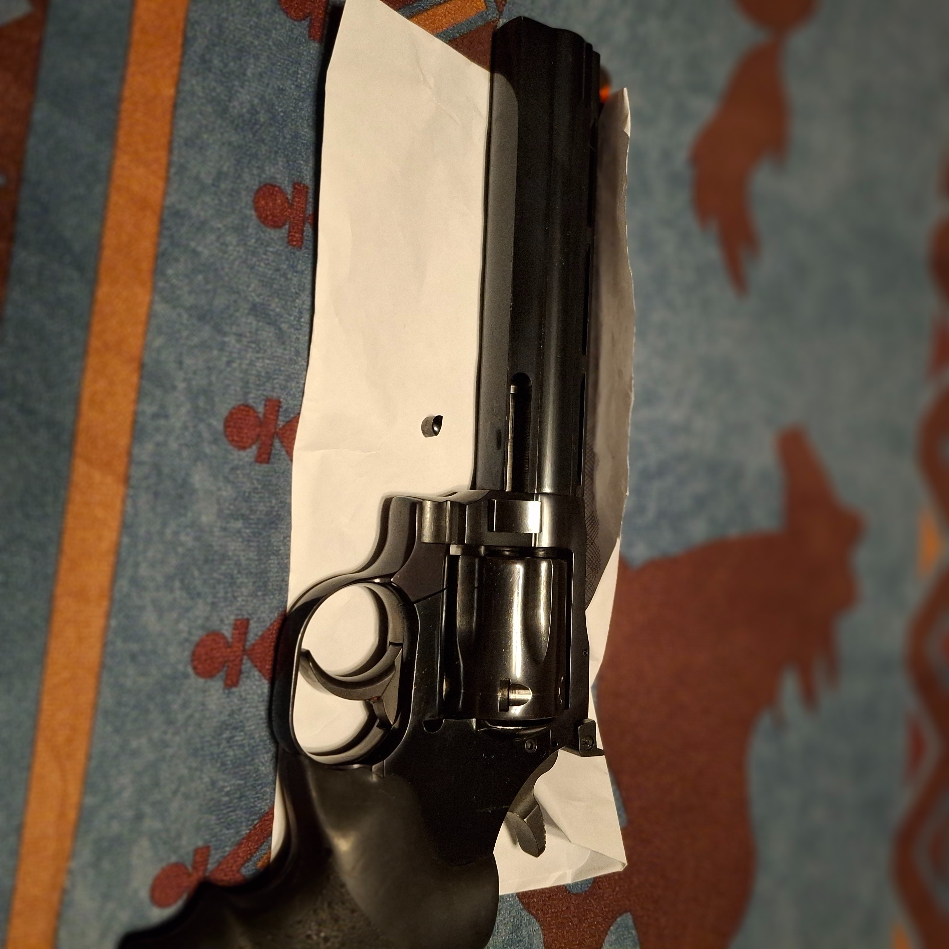

I have a Model 15-2. A small part just above trigger that extends out the side plate to keep the cylinder from sliding backwards when you eject shells fell out. Gun smith told me I need a new side plate as it is a permanent part of it. Looks too clean to me to have broken off the side plate. Any suggestions on how to fix. FYI I have been shooting Hornady 158 gr XTP with 15.2 grains of Winchester 296. Hornady Book 11 has 12.4 gr for min and 16.0 gr for max. Hodgdon website goes all the way up to 16.7 gr max for that powder and bullet so I don't feel like I'm over loading and fired brass looks just fine.  20251207_164728.jpgImage Enlarger

Dan Wesson /CZ may have some replacement cylinder stops(that is what they are called in Dan Wesson terminology). If not, eBay might have some. I have a bunch if you can't find them but they have a little rust and would have to be polished or reblued. I can send you one if you PM your address. Let me know so I know to check my PMs.
 I am not sure if they are press fitted or part of the original sideplate. I think they break off. The hole may have to be filed, clean or the stop fitted. It is not hard. Superglue the replacement in but be careful to not go below the sideplate or some lockwork may rub.
  It is not caused by the load you are using on your reloads. It is a design flaw and they get knocked off by hammering the ejector rod to remove stuck cases. When shooting you should take an unsharpened pencil and use the eraser end to knock out the cases while holding the cylinder steady.
   When removing the sideplate or replacing it do not pry it off or pound it in. With the stop removed the sideplate is very delicate at that point and the tongue under the cylinder will break off. Then you have a serious issue. You can have it braided back together or try to fit a new sideplate. DW doesn't gave any so eBay is the best way to find one. Most used sideplates have the scratches on them from the extractor star. Always keep you index and middle finger of your left hand pushing against the cylinder as you eject cases to keep the cylinder from closing while the extractor rod is extended. The main issue with a new sideplate is that the sideplate is fitted, before the gun is polished. It is extremely difficult to find a sideplate that will fit like the original. I used to buy bare frames from a packbreaker(who sold off parts) and rebuild them into finished guns. I have acquired, a couple dozen sideplates to choose from but sometimes none will work well. If you buy a bare frame ask the seller if he also has the sideplate.
  Lastly, read " The Average Joe Tuneup" in the Gunsmithing topic of the forum. They teach you to use a wood handled screwdriver, or rubber hammer to tap the grip tang until the sideplate pops off. Never try to pry it off. Dan Wessons were designed to not need a gunsmith for most things other makes do. No need to have a gunsmith or the factory to rebarreled or change the grip frame. You can fix most problems easily. Gunsmith are Colt and Smith folk. Don't let them near your Dan. If your gunsmith knew anything about them he would have known everything I just told you. They can ruin a Dan. And never file the sear the do a trigger job. It will ruin the lockwork. That is another topic. I can barely use a screwdriver and I learned to completely take apart and put together a small frame Dan( 22, 32, 357).

You may not even need a new cylinder stop.  If it is as least snug, you can try to loctite it in before you go and buy a new one.  Make sure the parts are clean before you assemble them.  If you decide you want a spare, ans Scout posted EWK is the source for the slide stops

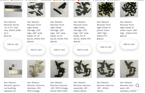

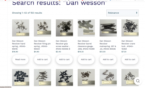

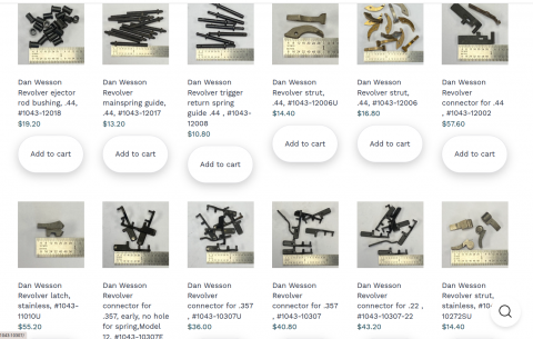

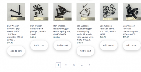

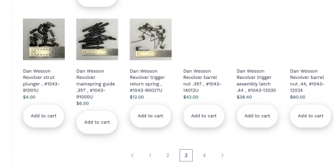

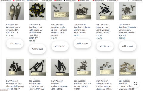

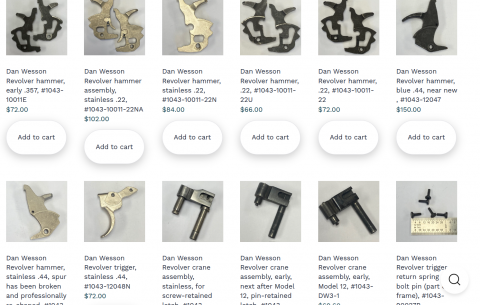

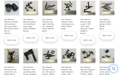

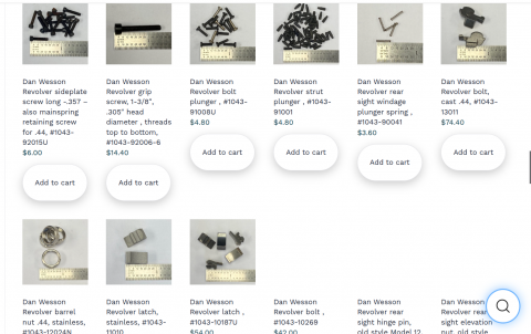

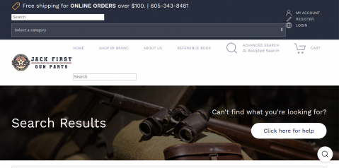

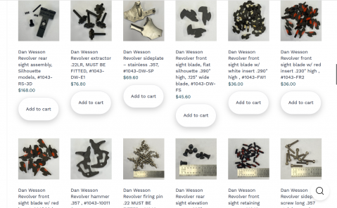

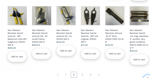

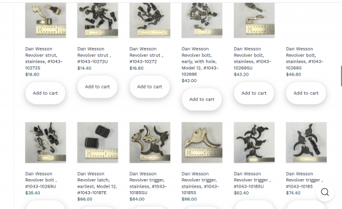

Another great source of Dan Wesson parts is Jack First. They are a bit more $$$$ but they by far have the largest inventory of Dan Wesson parts. I just got a shroud alignment pin from them I did not realize the small pin that holds the shroud in place is a small little thing but very important and it just presses in to the hole. Also They have every SEPERATE part needed for a rear site. I needed the pin that holds the front part of the rear site and got them there. The best thing to do is make a small list of things you may need in the future and just buy a few extra so you only pay the shipping once! Remember to click twice to see pick enlarged and double click again to open a window for even larger pics. This is their entire inventory!Screenshot-2025-12-08-12.51.27-PM.pngImage Enlarger

Forum Posts: 4378
December 8, 2025 - 8:24 pm
DakotaJack, I would guess 99% of cylinder stops are missing when noticed. At the range they are pounded out when ejecting stuck cases and GONE FOREVER.
 Stan, great info on Jack First. I have a lifetime of parts that Snake-eye and I bought and shared many years ago but if I ever find something I need I will check there. A rare part would be the end cap on a compensated shroud. I can't tell on my phone if they have them.

 I spent an hour on my hands and knees and was able to find the cylinder stop. From what I've read here I'll clean it up with some solvent and super glue or epoxy it back in. Good to know places I can still get parts. Thank all of you for the help.

de-grease both contact points with acetone/ fingernail polish remover or similar after cleaning...

Just ordered from Brownells, Theirs is the red version. Amazon had "Loctite 638" for 1/3 the price but theirs was the green version.

Just make sure the inside of the stop is flush, or slightly below internally before whatever adhesive you use sets.
If it's the least bit proud it will be a problem.
