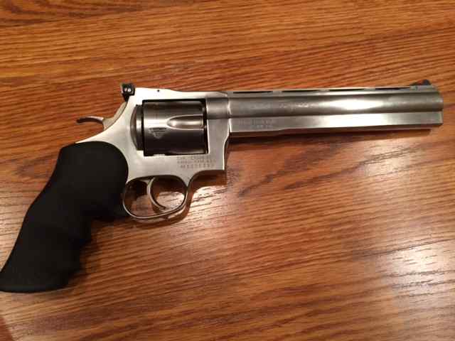

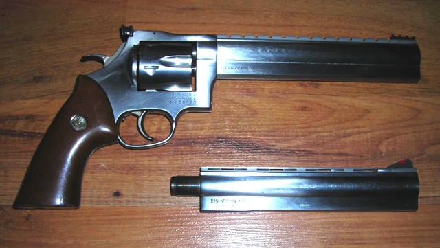

Finally found a 744 locally on Wednesday. It came with Hogue and original grips.The previous owner was unable to remove the shroud and had damaged the nut slightly so it was priced right.

I removed the sight and soaked the barrel end in Corrosion X overnight.
After a few cycles of heat gun, snowbank, heat gun, snowbank I put it in the vice, clamped Eric's tool on and after a few raps with a rubber mallet it loosened right up. The barrel is un-ported but the inside of the shroud was pretty dirty.  I would say it had been used at one time with a ported barrel and hadn't been cleaned well.

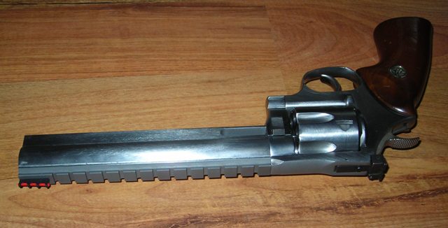

Here's a few pics with the EWK RH shroud I been saving for this occasion.

Hi Bob,
Good to heart from you. Im glad you finally got a gun to put the EWK on. Looks like a good 744, and if you bought it I know the price was right. Congrats,

Congratulations on the find. Not many come up in our neck of the woods.

Very Nice 744, Congrats on a nice find and getting the barrel off with out major surgery.
Like the pic's too.

A perfect example of "buy a barrel and the Gun will come"!
Thanks for showing it off!drool
