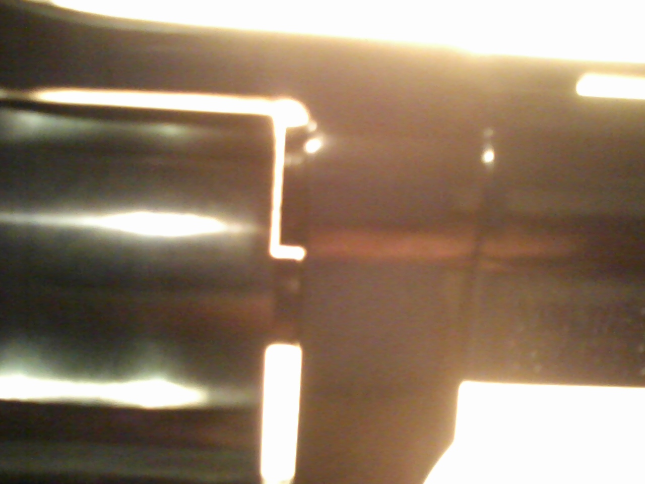

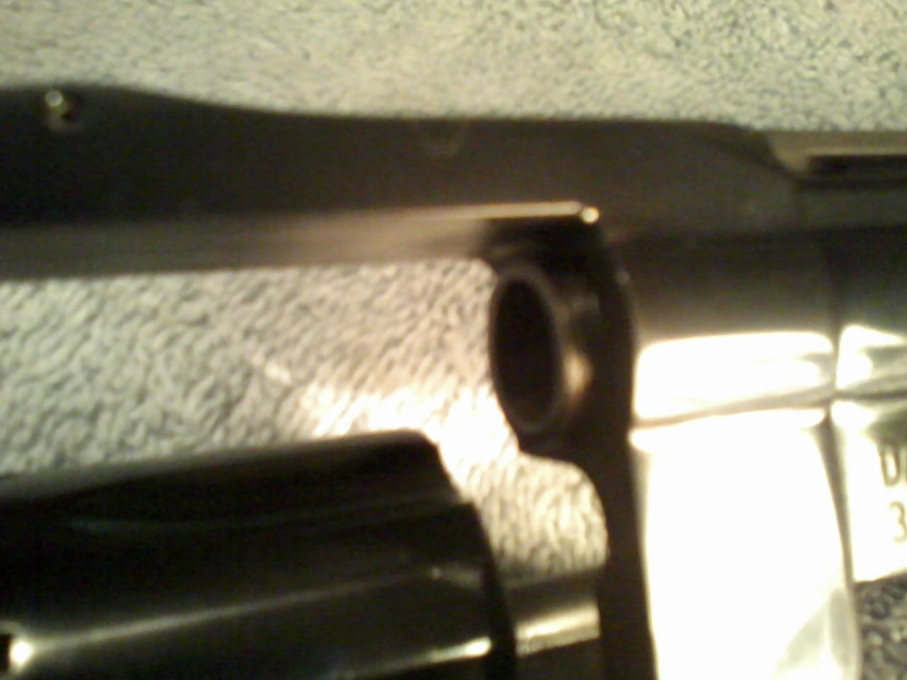

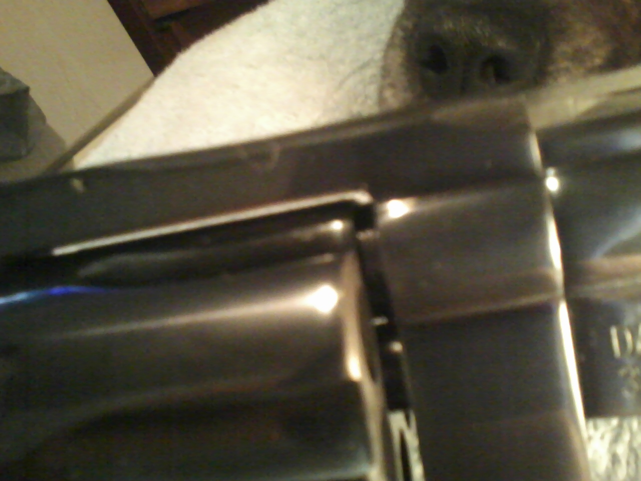

Hi everyone, Ive been a member here for almost a year now but this is my first post. Better late than never i suppose. Anyway a little over a year ago my father handed down to me a 15-2 and i instantly fell in love with DW. The gun wasn't shot since the early 90's so after a good check up and cleaning i took it to the range. It functioned perfectly. I went to the range about 5 or 6 more times and again no problems. So today i went to the range and encountered a problem. As i was putting a round into one of the chambers it wouldn't go all the way in. I looked in it and didnt see anything wrong with the cylinder so i tried a different round and it seemed to go in fine. After about 2 rounds the cylinder got stuck, after getting it open i noticed some lead shaving on the barrel. Was disappointed i had to cut the trip short but couldnt stand the thought of damaging my DW. Got it home and gave it a good cleaning and looked it over. My first thought was the cylinder gap, my father could not find the feeler gauge but said he would look again, but it looked pretty tight. The cylinder has no wiggle to it and locks up fine. Could it have been the ammo? I was using the cheap blazer brand that i got for $16 at a gun show. I'v used that brand before bought from a local sporting goods store and had no problems. Sorry about the picture quality (and my dog's nose) i had to use my cell phone, but i took a picture with a light behind to make it easier to see the gap. After looking at the picture with the light behind it maybe the gap is too wide ill have to get a guage to check it. All suggestions will be highly appreciated. Thank you in advance - Mikesecuredownload3.jpgImage Enlarger
securedownload2.jpgImage Enlarger
securedownload1.jpgImage Enlarger
Forum Posts: 4270
August 29, 2012 - 9:03 pm
First off dwf-welcome from the other side of PA!
That gap should be .006 and yours looks very wide.  An automotive feeler gage will do nicely for this if you don't have the original.
The tight chamber could be the ammo, or it could be fouling building up in there from shooting, especially if you shoot a lot of 38 specials.  A good scrubbing with a brush and solvent won't hurt anything, also do the cyl. face.
Look at you spent cartridges, are the primer strikes in the center of the primer or off center?  IF off center, you could be having a timing issue.
Did the problem occur in single action or double action or both?
Thats all I can think of off hand, I'm sure others will have more to add.

Thanks for the quick response Scorpio, mostly I'v been shooting 357 but on one trip to the range my father had a mixed box of 38s that shot very, very dirty. But I always clean my guns soon as i get back from the range. I scrubbed the cylinder face after todays trip. After reading your suggestion i remember noticing the primer strikes were off center and thinking to my self if thats normal. I mostly shoot single action but cant remember if it was happening SA or DA. And as you said im sure others will have more to add, this was the first place i thought to come for an answer.

If you were shooting a mix 'n match of .38 Spl & .357 you might have a build up of carbon atr the point where the .38 case ends. That would jam up a longer .357 case. Was there about 1/8" left when the jam happened? if so I'm voting for that as the cause.
Taking a brand new .357 brush, chucking it in a power drill & using that at low speed with solvent will remove the ring quickly without damage.
The gap looks way too wide, but it's really in need of measuring to tell for sure. The gauges from an auto parts store will work fine as has been said.

I would say at first glance as well that the gap is too wide.  I would suggest if the face of your cylinder allows for it to you could close that gap down to .003 or even .002.  Or anything under the .006 that works for your revolver.  That should make a large improvement.

Thanks all for your thoughts. Im going to pick up a guage from the auto parts store and check out the gap. I can see a build up in the cylinder and there was about a 1/8 in out when the jam happened. I will take care of that this weekend. But what has me worried now is what Scorpio said earlier about the primer strikes not being centered. How can i check that without really shooting a round? And what would cause that and how would I fix It?

okay looking at all the pictures of the primer strikes thats what mine looked like so thats not a problem. Second i just checked the cylinder gap and it is at .006 i guess the light i put behind the gun made the gap look wider than it was. But I just noticed as i was looking the gun over when i pull back the hammer the cylinder will not lock fully lock into place. if i pull the trigger the cylinder will fully lock in place but i cant tell if the gun is firing before its in place. I also noticed if i pull the hammer back quickly it fully locks in place, but at normal or slow speed it will not lock in. I will try to post some more pictures but again i have to use my phone
