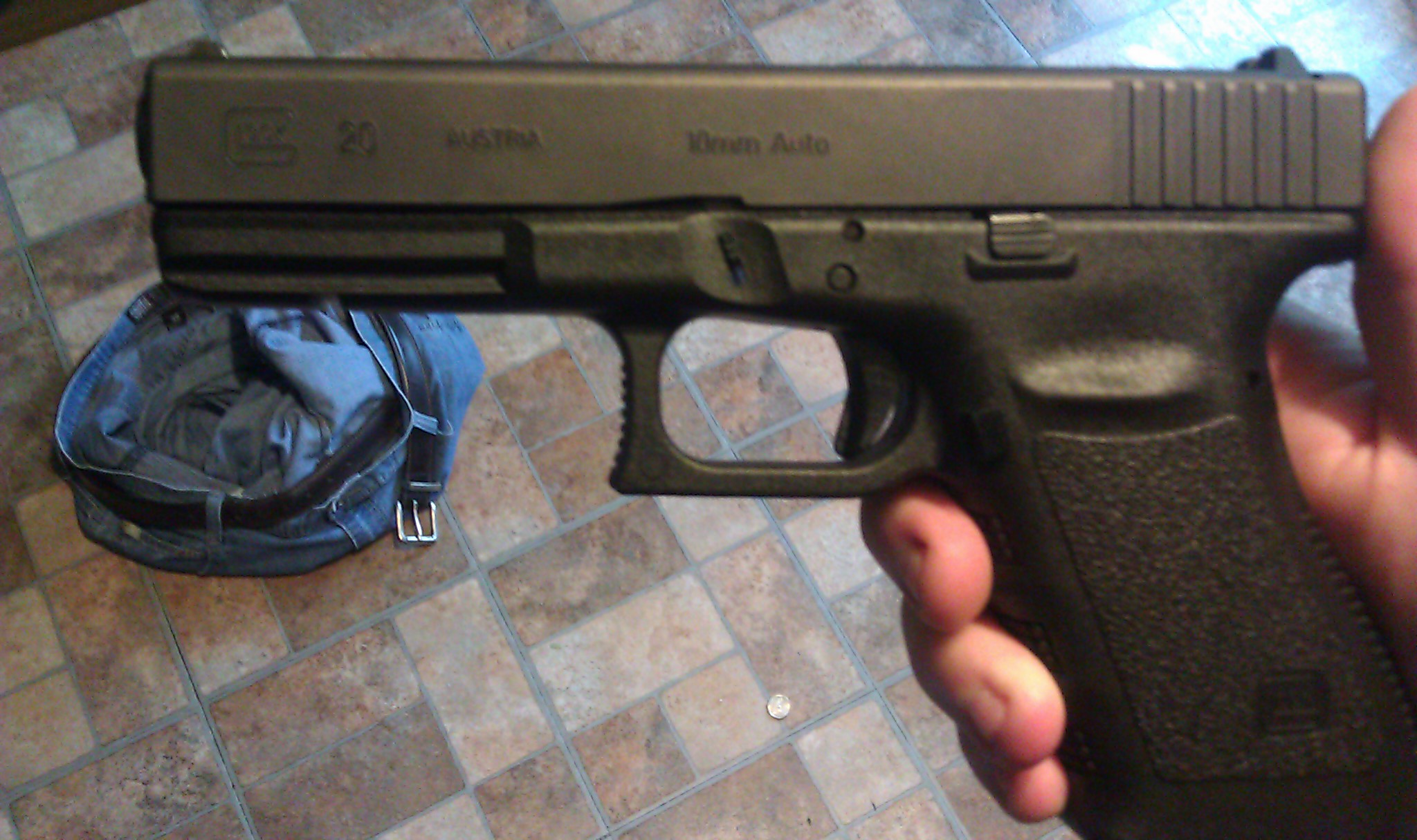

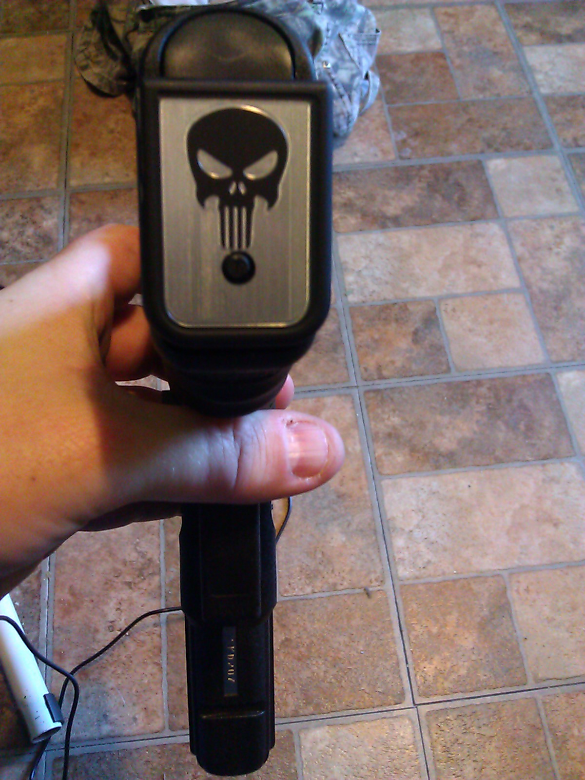

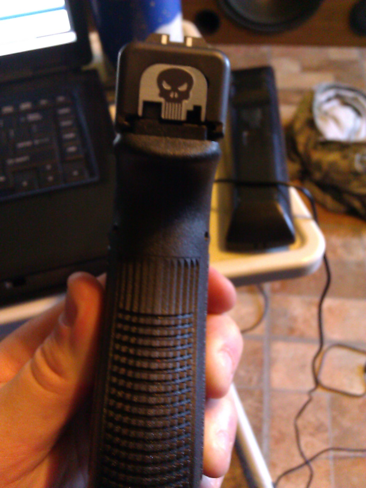

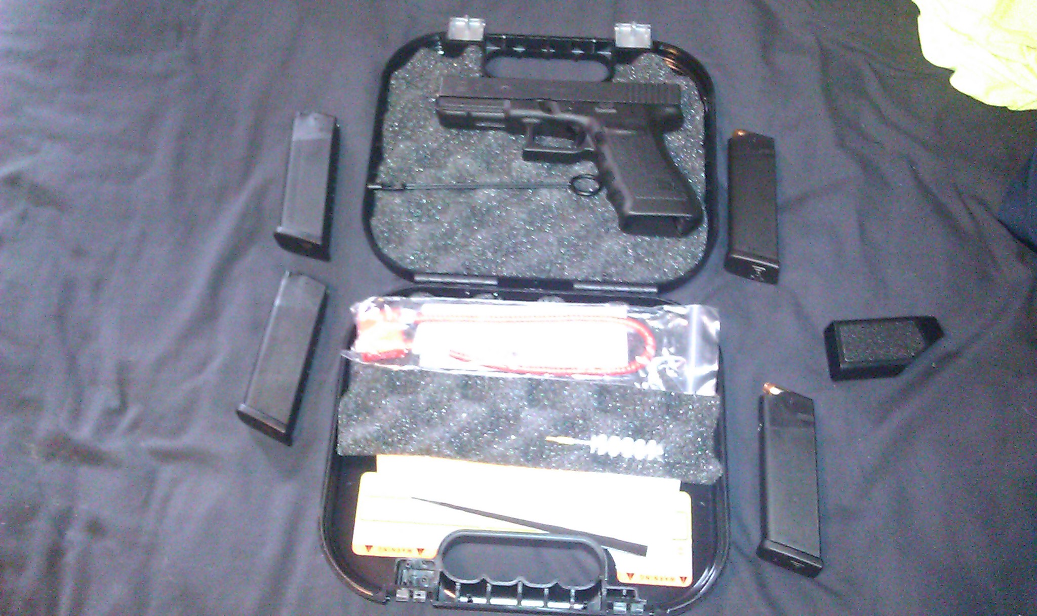

Glock 20 10mm  I put punisher Slide plate and floor plate on it to break up the monotony of the black brick  , also got 2 15rd mags for it , floor plug , 10mm to .40 conversion barrel  and Im debating on whether to get a 6 inch ported Lone Wolf 10mm barrel and tru glow TFO night sights .

Good looking Glock.  With all those big clips... your next hobby is reloading!
Congratz!

laughing laughing laughing laughing laughing laughing laughing
We can all see how excited you got in pic 3 lol2.

Now that is a great Christmas present even if you brought it yourself, the best kind.

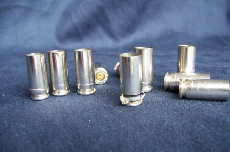

Now when it comes to Double Tap ammo…I''ve got a problem I had two case
head ruptures from weak 10mm brass….

wow I got 100rds of double tap   50 180gr and 50 165gr ...  what 10mm was it in? could that blow my glock up? I also took out stock barrel and am using a Lonewolf 10mm barrel too . think that will help with the DT failure?

January 11, 2012 - 8:09 am
What KB's I had was with the 180gr Controlled expansion, My Colt
Delta Elite did not have a full supported barrel but the feed ramp is
not nearly cut back as the First Generation Glocks either.
10mm brass is(or is suppose to be) alot thicker at the case head for the
very purpose of supporting the higher pressures the 10mm dishes out.
If pressures are kept at SAMMI max or less you should have no problem.
Especially if you are using Star-line brass, I have even shot some max loads
and not even a slightest bulge/smiley even showed on the case head when
using Star-line brass.
Double Tap ammo is about 10-20 % lower pressure than SAMMI max
and is an approved ammo by all major firearms manufactures, search
the web and you will find DT velocity ratings are way over rated as well.
The stuff that list at 1350fps is lucky if it gets 1200fps.
When I sent my Delta and ammo to the Colt to see if any thing was wrong
the reported cause was weak brass. This happened not once but twice
on two different batches of ammo. I ended up sending 6 boxes back to
Double Tap for a refund which was a long drawled out process and their
so so attitude and lack luster response time left a real bad taste in my
mouth so as you can tell I don't have much nice to say about them.
You on the other hand have the Lonewolf 10mm barrel which I believe
is a fully supported chamber…right?  If so I would have no worries with
using it, alot of guy's at GlockTalk shoot some way over pressured stuff
with the fully supported barrels. Also my problem was back in Feb 2011
so were alot of other complaints, Google DoubleTap KB's or
DoubleTap  case head ruptures. .
No doubt DT probably already has addressed the issue with the weak
brass by now….you would hope wow.
