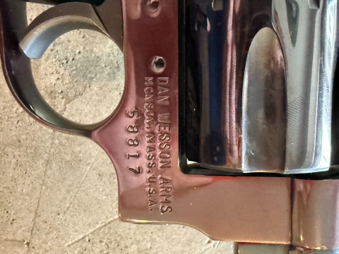

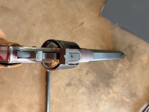

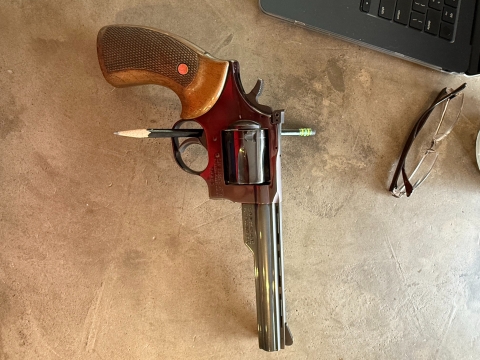

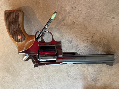

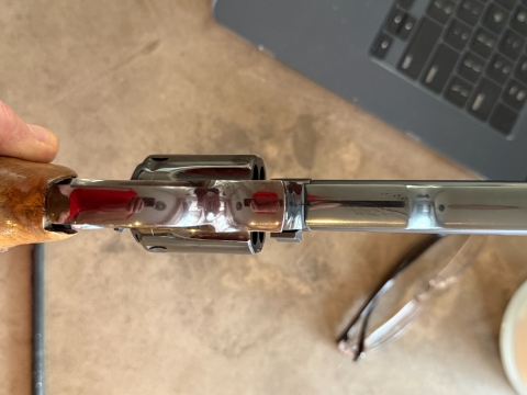

Greetings from northern Virginia (NOVA) I recently picked up my father's old Dan Wesson .357 from my brother who needed money. It seems to be in decent shape though I'm not sure what model or year it's from but think my father may have purchased it in the late 70's. It was manufactured in Monson, MA. Can anyone help me identify it? I will add it needs some minor work to reseat the barrel. My youngest and I were shooting it and were getting sprayed with blowback. Turns out the barrel had come unseated and no longer had the 0.006 gap tolerance to the chamber. I'm waiting on a tool to do the repair that seems pretty straightforward. I'm also interested in getting other barrels for the gun. Thanks for the forum, I look forward to learning more about the gun. Photos attached. IMG_5932.jpegImage Enlarger

Good to have you on the DWF. Setting the barrel to .003-.004 usually takes care of any debris issues. I'm glad you get to shoot your Dad's gun with your kids.  Always nice to keep things in the Family! The revolver is a mid 1970's ('75-'76) model 15-2 but grips appear to be aftermarket/ another manufacturer. Once you get the barrel set you shouldn't have any issues.  Of course, if you do, here we are....

The grip could actually be original to the revolver. Looks like the “powerwood” version found on many of the 15-1 guns made in 1974 (I have one very similar). My 15-2 is less than 100 serial numbers before yours. I’m guessing that DW may have used up the last of the powerwood grips on the earliest 15-2’s. As far as EWK goes, I have had very good products and service from them.

3ric is correct. One of the first 15-2s. They started in late 1974 at serial number 50,000. Definitely a Powerwood grip. They are lightly regarded. Plastic grips that don't wear well.

In my range bag, I carry 0.002, 0.004, and 0.006 gauges.   If you set the gap to 0.002, then set it on the proudest chamber as not all chambers may gap the same.   And I also carry 1" squares of gray scotchbrite as burnt powder will close the gap sometimes and cylinder and barrel may need an occasional brushing to get the gap back.

What Scout said! Small gap may need frequent wiping of the cylinder face. I mostly use an automotive set of feeler gauges. Many different thicknesses all together and easy to hold.
  Once you get a feel for the size gap you can hold the gun up to a light and judge the size of the gap while you cycle the cylinder. Much quicker than measuring each chamber with a shim. Large frame guns have more uniformly perpendicular faces and 2 thousandths of a gap is usually enough. The larger cylinder doesn't expand as it heats up.
