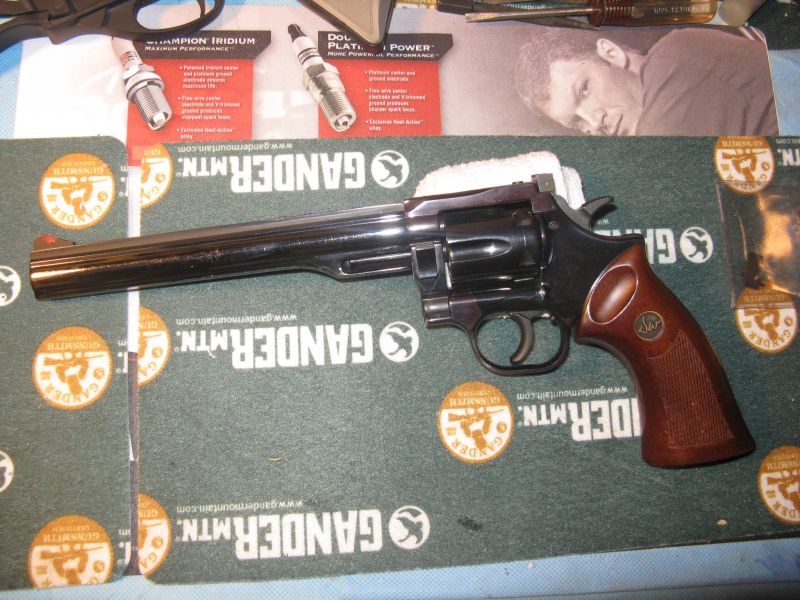

Hello,

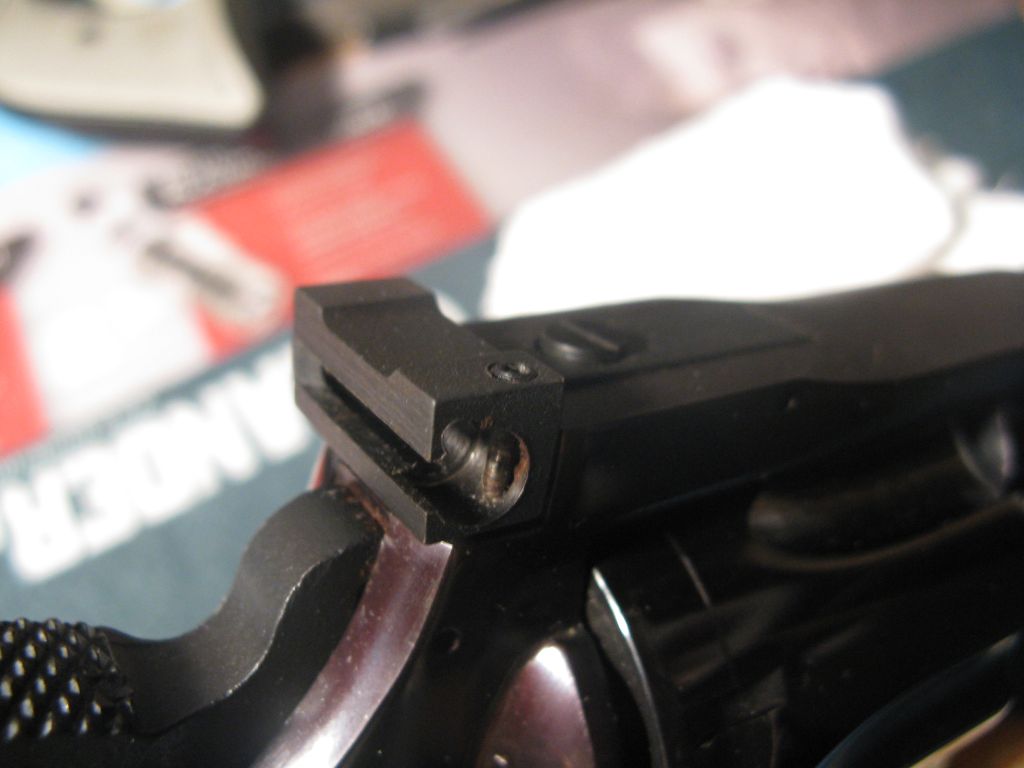

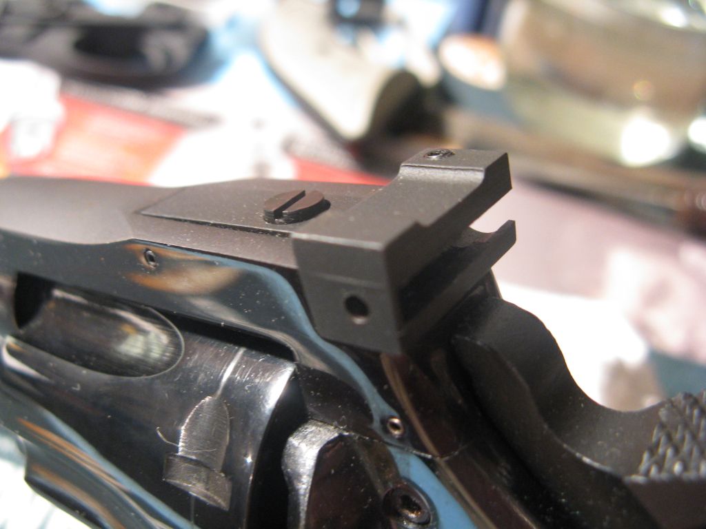

I recently just purchased my first Dan Wesson revolver.  It came with the 8" and 2" barrel, tool, and feeler gauge.  The question I have is as to which model it is, a 14 or 15.  The rear sight blade was not attached when I purchased it and I thought I would just order a new one from numrich.  But the rear sight retaining pin I got from them was just that, a roll pin.  It looks like I need a small cap screw from the looks of how the sight is made, which leads me to believe it is a model 15.  Hopefully someone will know where I can get the part I need for the sight.
Thanks!Image Enlarger

 It appears that you have the model 15-2. I believe you need the windage screw which is available from CZ. Just go to the right of this page and click "where do I order parts?" It will direct you to a parts list. The windage screw looks to be $3.95. You may also need the blade, I didnt see one in your pics unless it is on the table in the backround.  Welcome

You're right, you have a Model 15-2 (standard shroud) target revolver. The Model 14 is a service revolver, with fixed sights.
Numrich is a good place to check for your rear sight pieces, or DW/CZ, as Palo suggested. Let us know if you hit a snag finding the parts & we'll try to help out further.
Looks like you got yourself a nice one.Laugh

Thanks for all the info guys!  I went to the CZ page and found the Dan Wesson page in the web store where you can order parts but did not see the windage screw that was mentioned.  Am I in the right spot?  Maybe someone can direct me to the right spot or let me know the part number.

I just got off the phone with the parts dept trying to purchase the windage screw for the 15-2, they are out of those and don't carry them anymore.
Does anyone know the length and thread size on that particular screw?  I will have to see if I can locate one somewhere else.

Even better, buy a Millett rear
http://www.millettsights.com/controller.php/cat09/revolver
which replaces the entire rear assembly, with what I think is a better rear sight. If you really, really, really want a DW rear, rather the the much better Millett, PM me with a shipping address and I will send you a DW rear sight.
