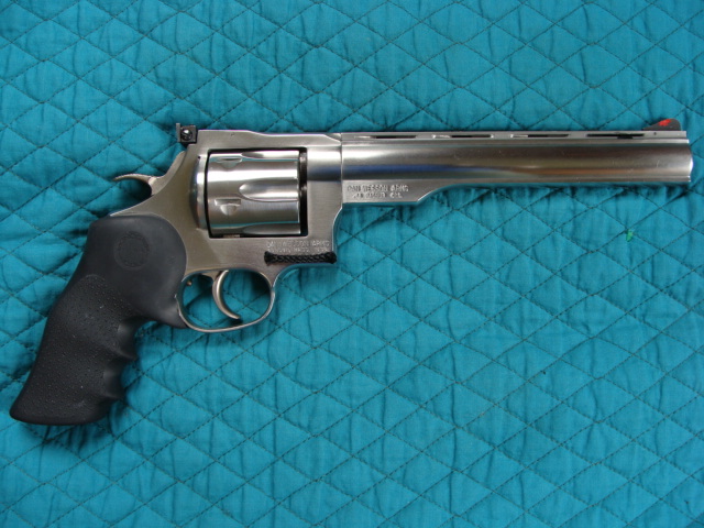

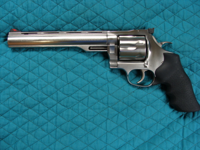

Hello Gentleman, Figured it was time to stop in, introduce myself and my first Dan Wesson and the story that goes with it.
My Grandpa spent alot of time up in Alaska and never went anywhere without his Ruger .44mag. I grew up hearing story's about him and that .44, like how when my dad shot it grandpa had to catch him. And I regret not getting to shoot it with him at his eastern WA property now that he's gone. The Eastern Wa property now belongs to my cousin, and he told the family that we will all get to use it, but we must be armed due to bear and wolves.
It was after that I post a wanted add on my local gun site for a Dan Wesson .44mag because they are strong enough to handle heavy bear loads. Well a couple of weeks went by with no hits, so the night I was planning on ending the hunt I let it go till morning since Christmas was coming soon . Good thing I did because I woke up to a pm from a member. Long story short, a deal was made, the snow stopped, my girlfriend at the time was snowed in so I went alone, yet the passenger seat didn't feel empty and I had nothing but sunny skies for the 160 mile drive. The whole thing, felt like I had help! So with a little help from grandpa I present my new Dan Wesson 744 8V.
Now for the spooky part, based on research I done so far this .44 was made the same year I was born.

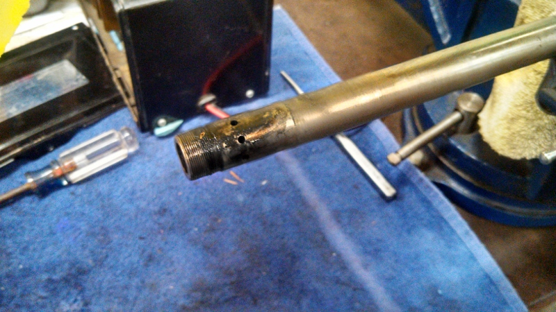

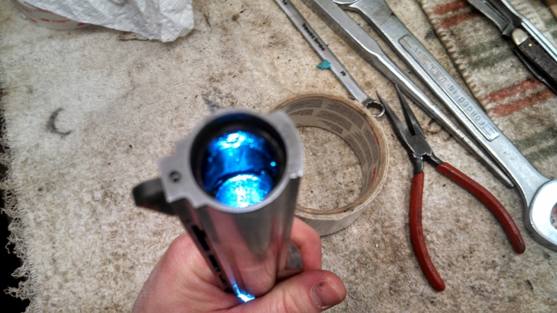

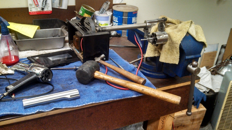

I decided that I should take the shroud and barrel off and give it a good cleaning. The front nut came off easy, but the shroud would not move. So I shot some of dads special rust killer in the front of the shroud and down into the ported vents. To help really get that in there I used dads heat gun to try and get some expansion. Still would not budge by hand so I opened the cyclender and placed a small rag in the indent where the ejector rod goes in the shroud. I very gently used a punch and hammer to tap the shroud off the barrel and this worked.  I could not believe the amount of crud built up inside.

I see the rubber mallet on bench, that is my removal tool for the stuck shrouds!

Welcome to the Forum. You have learned a first critical lesson regarding the Power Control barrel-keep it spotlessly clean inside that shroud, or better yet, just get a non-ported barrel.
DW "Power Control" is pretty pointless, IMO

+1. I just had to beat my shroud into submission whippingafter being lax after shooting some plated bullets with my PC barrel. Keep that dude clean and don't shoot lead boolits out of it.

Absolutely unported barrel only. The ported barrel will peel copper and lead off the bullet and pack so much crap into the shroud that you may need heroic measures to get the shroud off.
