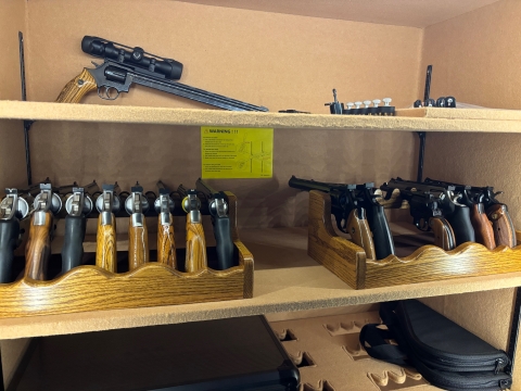

I keep all of mine outside the case in a wooden pistol rack inside my gun safes.  All get a good coating of Ballistol to prevent rust.  I have quart sized silica canister in the safe too.

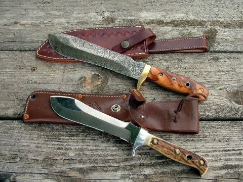

There are essentially 2 kinds of foam.
Open cell: The soft squishy stuff. Feels (& acts like) a wash sponge.
Closed cell: the firmer not so gushy stuff ( like in sleeping pads or yoga mats.)
NEVER EVER even for a short time (like overnight or coming back from the range) store them in the open cell its a moisture trap of the worst kind.
Any GOOD gun wrap or case will have closed cell, if it doesn't refuse it.
Personally I use old, worn out T-shirts, cut to size & liberally oiled as a wrap.
Its worked on everything from B/P revolvers to rifles, S/S & Damascus knives to guns without worry.

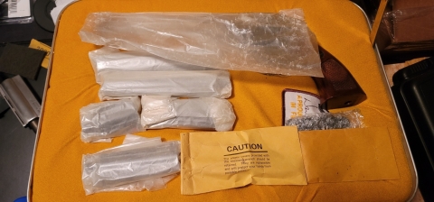

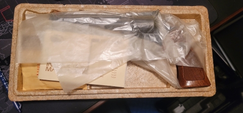

Everyone is going to have their own ideas.  As Ole Dog said, if you are in a humid climate, keep the windows closed and control it with heat or A/C.   Here's a quick and simple method to protect the guns in the cases.....double over a piece of wax paper, spray the gun with a light coat of silicone, and wrap the gun.  Done.
