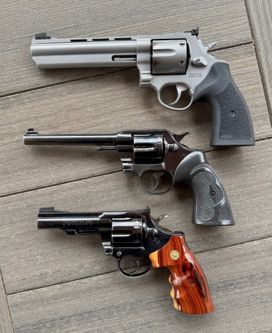

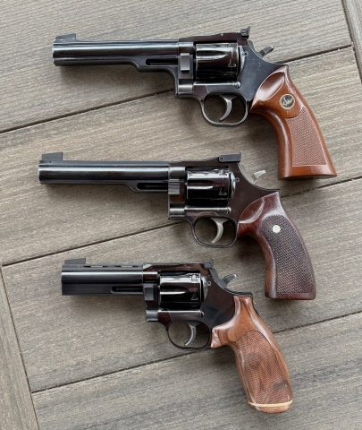

I do not consider myself an all around handgun shooter, but rather a specialist I suppose. That specialty being long range handgun shooting with open sights. I’m not claiming to be especially good at it; but it’s what I’m always striving to be better at doing. So, for me the sight known as patridge works the best. Named after Eugene E. Patridge who introduced it near the dawn of the 20th century it consists of a front sight that is perfectly perpendicular (or even slightly rearward leaning) to the barrel creating a crisp sight picture under most lighting conditions due to the fact that glare is virtually impossible. Is it a good all around sight? No. It will certainly snag when drawn from a holster, and under poor lighting conditions it will be very difficult to pick up, yet for the target shooting it was designed for, it works. Nuff said.
The first photo shows my three DW’s that I’ve recently converted to the patridge system. The 4 inch 15-2 was easy; dropped right in. The other two (pork chops) required some tedious gunsmithing. The second photo shows three others in my collection which all needed work. The Taurus M44 is fitted with a S&W front sight. The Colt Trooper MK lll is wearing a DW front sight (don’t ask), and the ancient Colt Official Police required hours of exacting work with a Dremel tool and a diamond file.IMG_1972.jpegImage Enlarger

Nice job.  I once had my .41 maggie set up with a Patridge front sight and a Ruger Blackhawk rear with a one ragged hole peep sight installed.  The Patridge- Peep combination is a great setup for older eyes.
