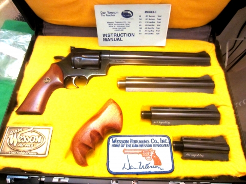

I finally got all the barrels and the frame is back from the FFL/Gunsmith taking care of the cylinder problems! This case is a Samsonite Quantum Focus they made them in later years and were strong cases with heavy duty locks and combo lock. not a case that was used by Dan Wesson but a close looking case with lots of upsides! They could hold extra weight with the large frame Supermag sets inside! I know these were not much of a stock item you could buy but sure looks nice. I'm working on a new case for this set and will post some more photo's when ready. I have to get the new gold name plates. I was saving correct Palmer Supermag manual and a correct patch!IMG_7756.JPGImage Enlarger

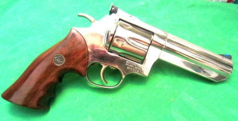

Got it thanks! PS the Roland I just bought also did it a couple of times also when pointed down. He cleaned it and it went away. This is kind of a problem it seems with these older guns! Not one of my small frames have done it so that's good anyway! This 44 FB nickel Dan did it really badly. It would spin backward and my FFL/Gunsmith worked on it cleaned all the gunk out of it and now it works perfectly now. I was a bit broken when I  first found out how bad this one revolved backward. Just a good cleaning and it's good as new! IMG_7771.JPGImage Enlarger
