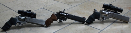

January 22, 2009 - 7:18 am
I also have a Monson-made .375 Supermag V8S. Here's a close-up.
Forum Posts: 6205
January 22, 2009 - 8:59 am
Thanks for the picture IHMSA... Very nice looking SuperMag!
