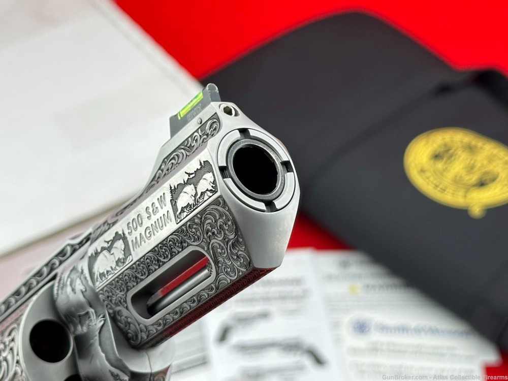

Is S&W doing barrel nutted shroud assemblies?

The S&W performance center revolvers have used this for some time, but the barrels cannot be changed out by the owner. Only qualified gunsmiths have the tool, and they only use it for servicing. But, is does have the benefit of the tensioned barrel for accuracy.

Makes me wonder how close a DW barrel wrench would come to fit that S&W nut?

Eric sells a barrel wrench for the Smith Wesson TRR8 . Similar high quality design as the DW

I believe the barrel tool is a mandrel that uses the rifling to unscrew the barrel. The barrel screws into the shroud I think.
  Bob Serva of Norwich made a deal with S&W to manufacture the frames of Dan Wessons and Serva made the barrel assemblies. 6 of each of 6 calibers were produced as prototypes. In exchange S&W recieved DW barrel and shroud tech. S&W used it on their new X frame guns and then the Scandium guns and others. When Serva sold DW to CZ the prototypes were distrubuted to executives and family. Some have showed up on Gunbroker. I have a 22, 357 and a 44 mag. There are also 445,45acp  and one other I don't know what caliber.
  Manurhin made an MR 73 with interchangable barrels AND calibers for a while using the barrel and shroud. Korth, Janz and others did or do too. Many other revolvers now use it but none are as user friendly as Dan Wesson. It is now routine for accuracy but most gun makers don't want owners doing it.
