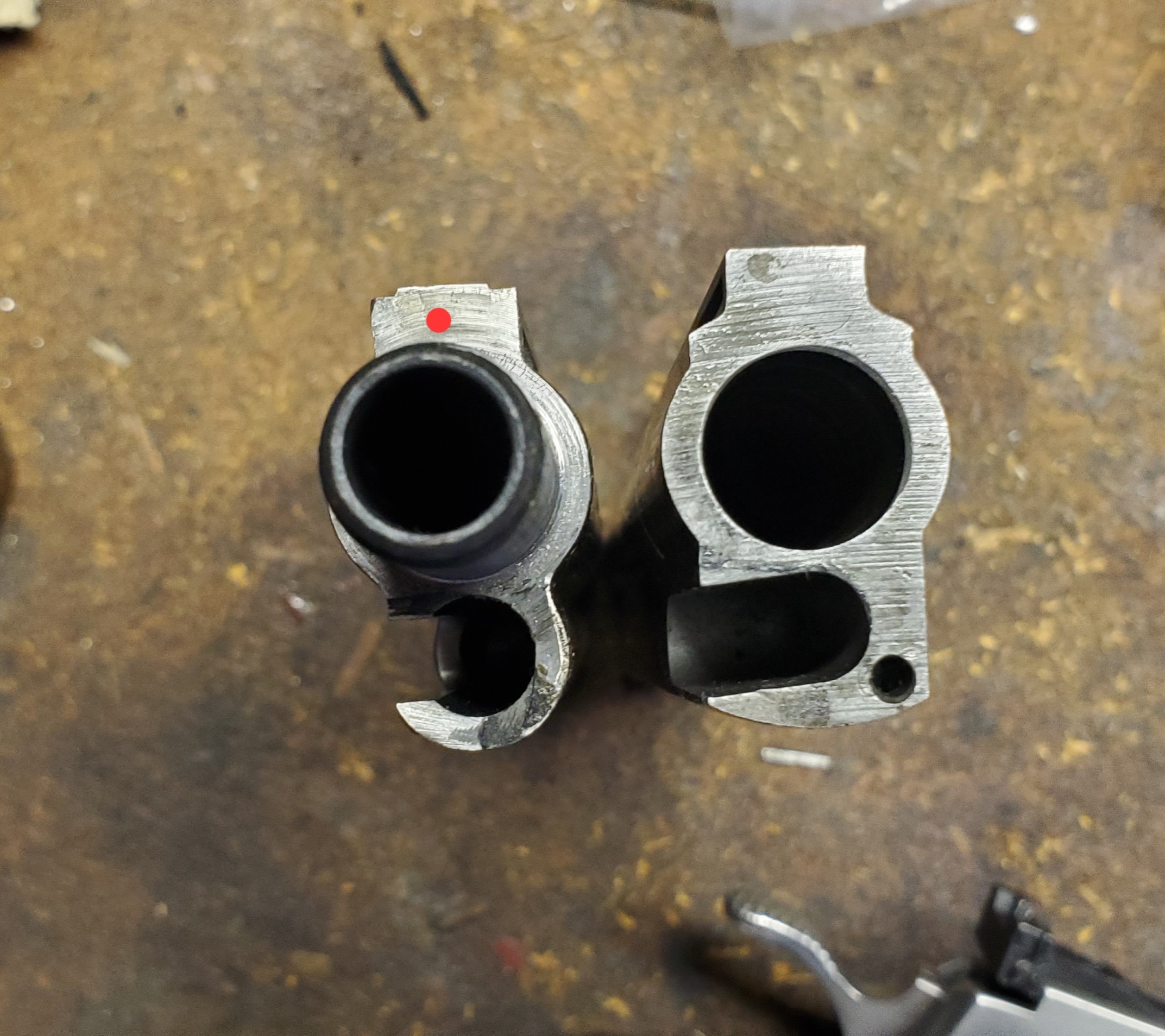

In July I bought a Stainless 6" Python with a bulged barrel. After getting it and inspecting it for potential cracks or a tweaked frame I jumped online and confirmed that nope I'm not excited about the price of a 2 pin Stainless barrel. I had already given some thought to doing an interchangeable barrel like on a DW. So I started getting to work drawing it up to see if it was possible and confirmed yes it can. Machining out the old barrel was a pain but I got it done, used a standard DW small frame nut from EWK (to use a standard small frame DW tool) and an old damaged 6" (Colt) Trooper barrel. So from concept to shooting hope you enjoy the pictures. I doubt it’s one of a kind but I couldn’t find any examples other than some slight talk of the concept on the internet.

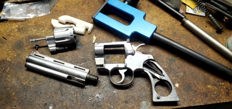

Torn apart getting ready
16244-1.jpegImage Enlarger

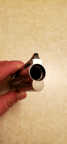

See the bulge?
16000.jpegImage Enlarger
Next to a small frame barrel. The “normal” DW locating pin position won’t work.15986.jpegImage Enlarger

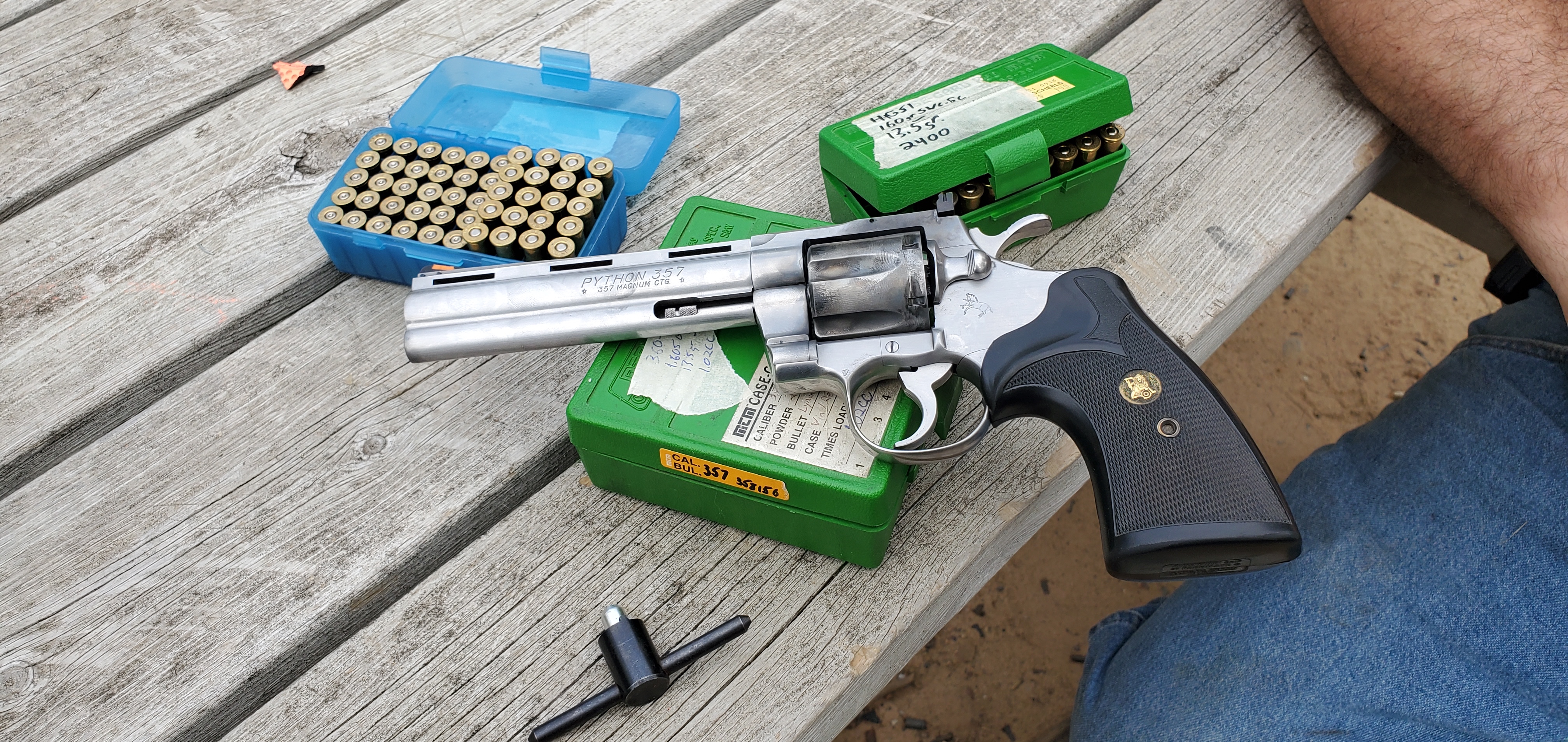

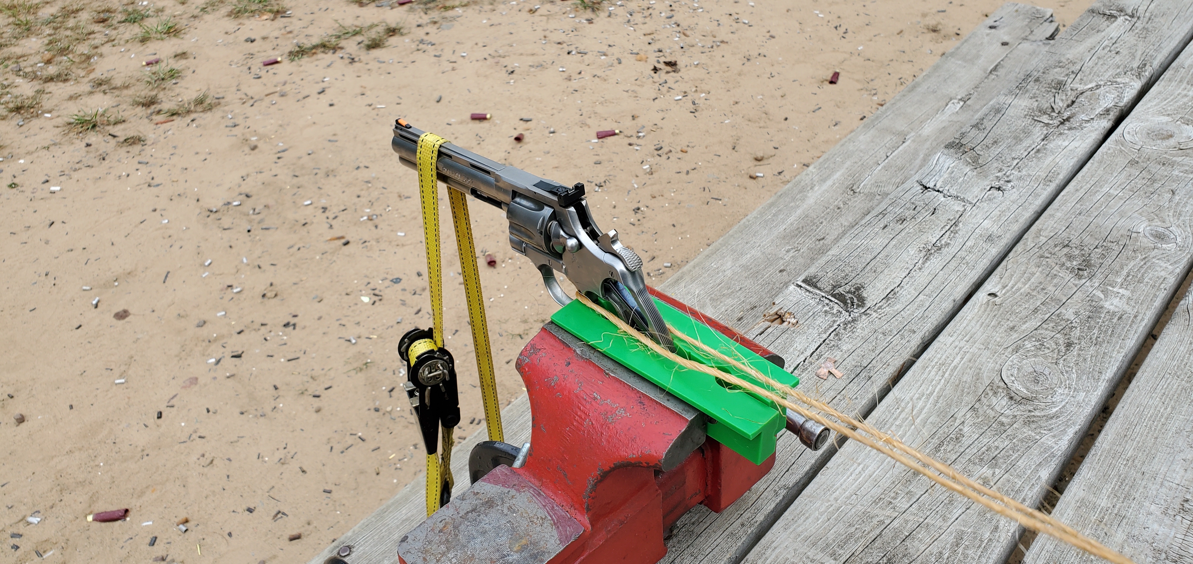

All strapped in for a test fire. I know it’s a fancy setup 😉. I hadn’t shot it since buying it and had a very slight worry that it may have an issue so decided to be safe. Remember it had a bulged barrel.16337.jpegImage Enlarger

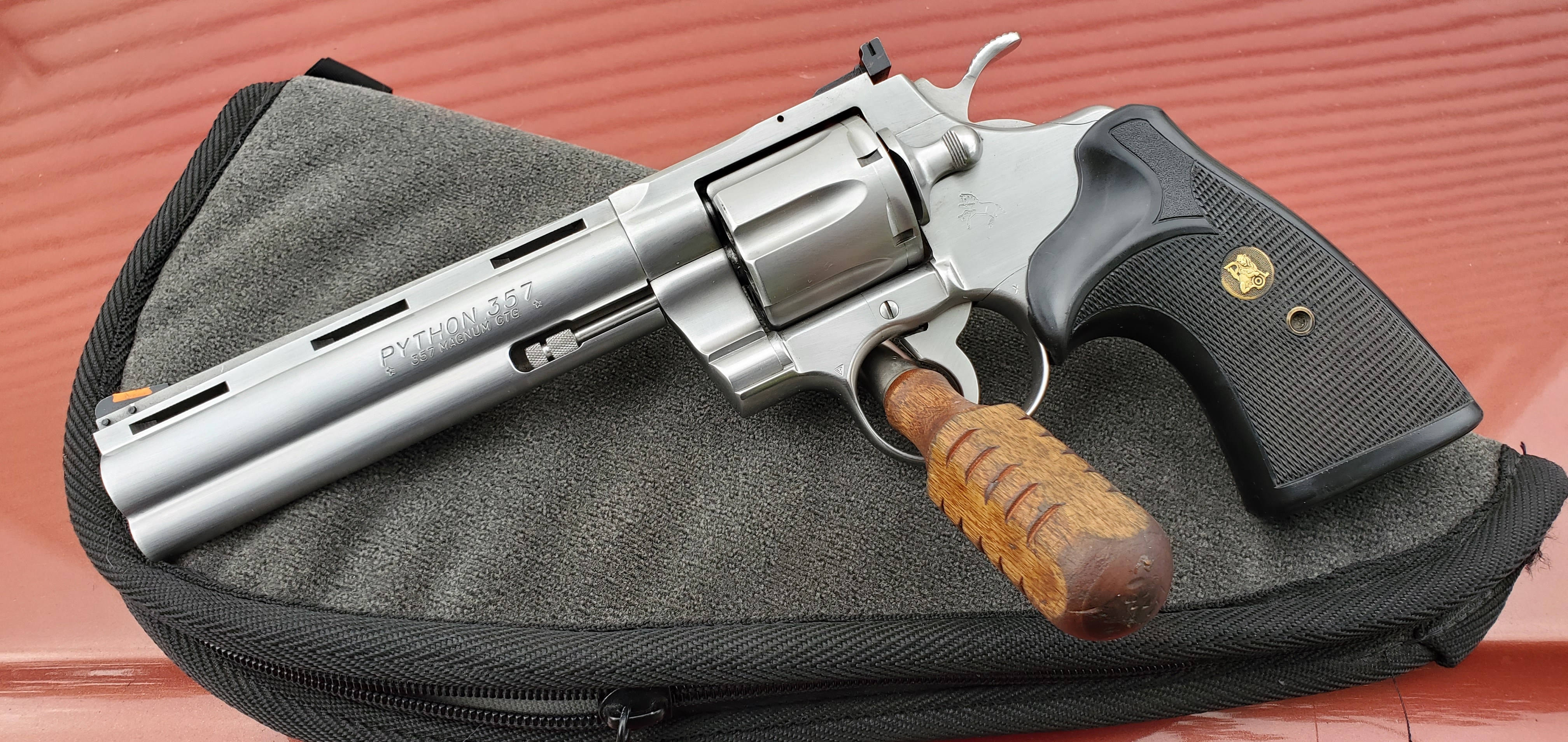

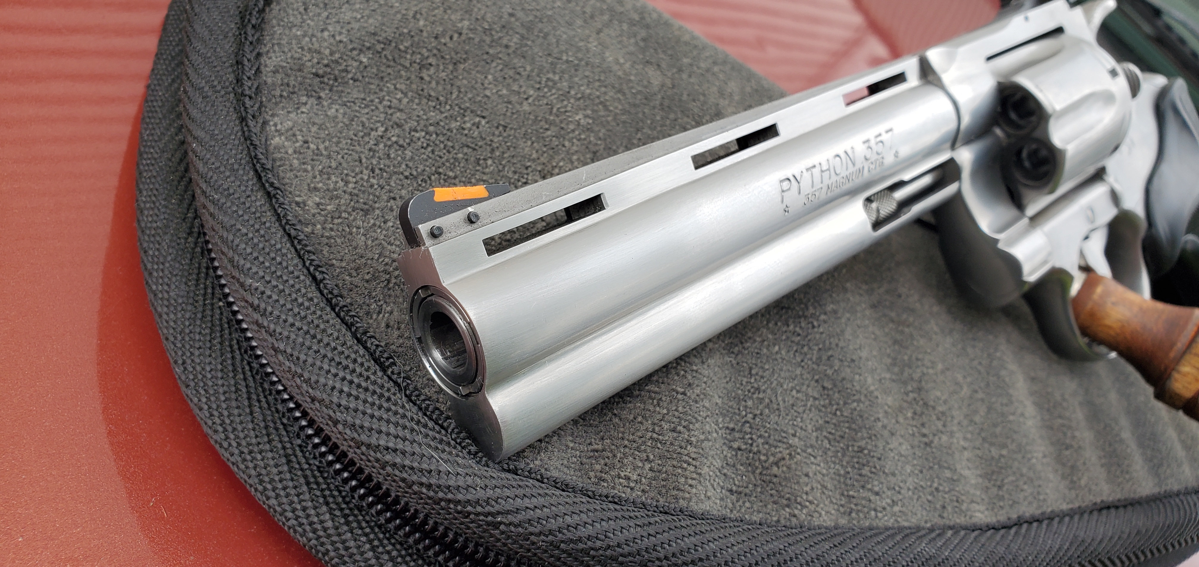

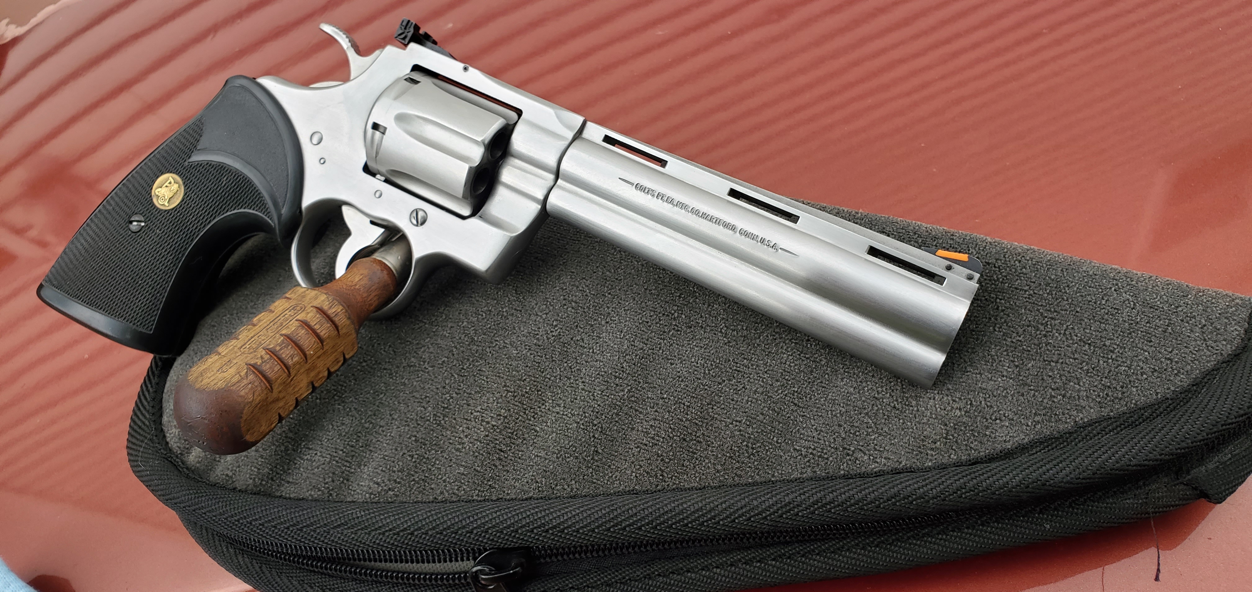

Some glamour shots16332.jpegImage Enlarger
16330.jpegImage Enlarger
16329.jpegImage Enlarger
16333.jpegImage Enlarger
It shot just fine (6 shots @ 15 yards off hand)16338.jpegImage Enlarger

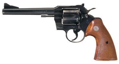

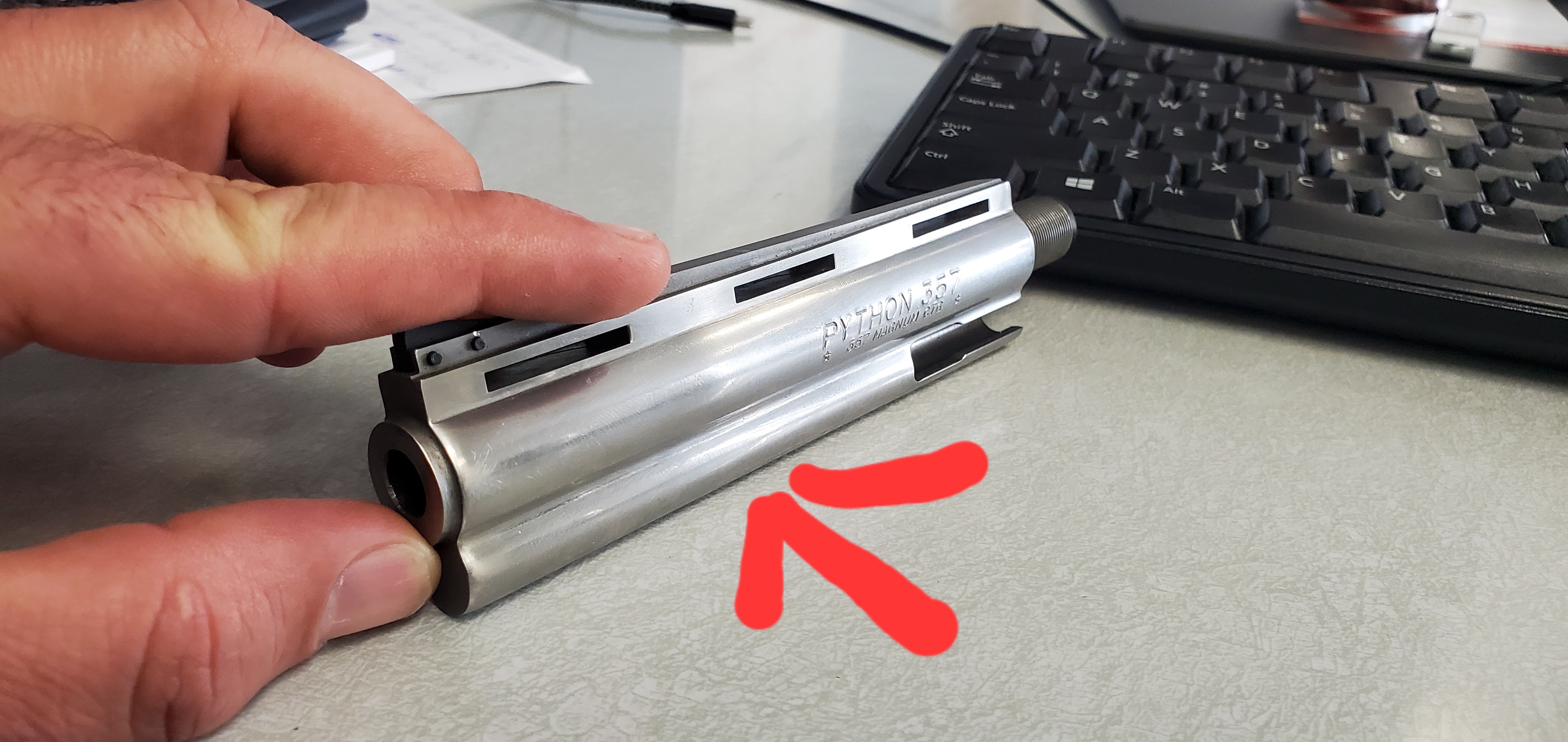

Yes it was a 6” Colt Trooper that ended up getting damaged when it was being removed. It used to look similar to this. Now it looks just like a Dan Wesson barrel except the frame end is .030” bigger.
