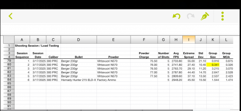

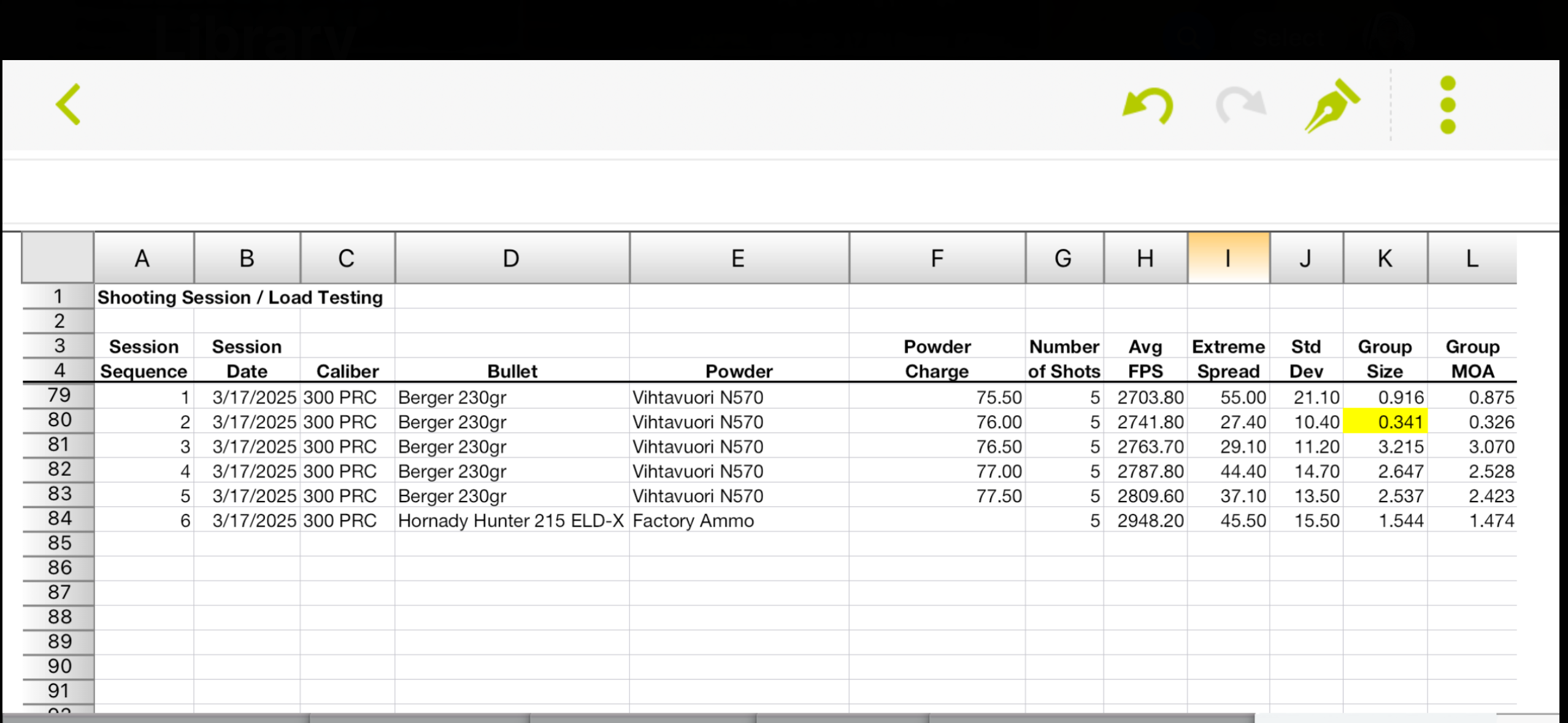

IMG_6748.pngImage Enlarger
I may have found my node.  Berger 230gr, VihtaVuori N570 76.0gr.  It was crazy windy today so my group could potentially been even better.  Hopefully I can repeat this grouping, then I’ll know for sure I’ve found the load my rifle likes.  I can maybe improve it some by testing shorter jump distances.
This has been a fun process.  I’m OCD anyway so this feeds that big time. laugh

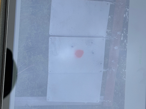

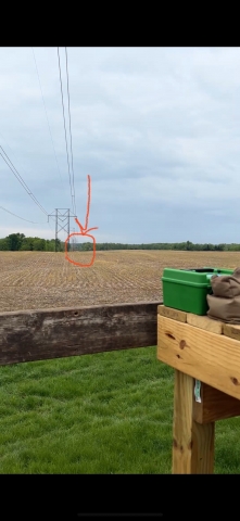

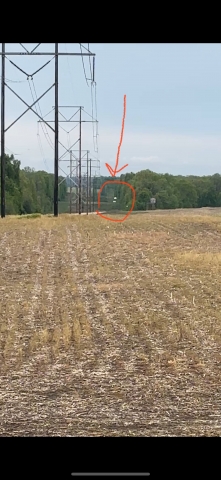

Final Update:
We have similar targets set up at 1500 yds & 1-mile which are painted white with orange bullseye.  These pics show them with my iPhone zoomed all the way and without zoom to give perspective.  1-mile target appears above the 1500 target in the photos.
IMG_7336-1.jpegImage Enlarger
IMG_7337.jpegImage Enlarger
I first shot at a 12” swinging steel target at 600 yds to confirm scope windage and elevation settings.  My sccope was zeroed at 175 yds.  Ballistics calculator app said 10 moa elevation which turned out to be dead on, however it took 5 shots to determine correct windage to be left 0.5 moa.
I then switched to the 1-mile target (overall 22” tall x 64” wide).  I dialed in 57.50 moa elevation, set parallax, set zoom to 30x, chambered first round, double-check scope bubble level, sighted in, then flipped safety off.  Took a breath and slowly exhaled, at full exhale I set off the first shot.  It took about 3.5-4 seconds and it was an impact!!  The Caldwell Flashbang lit up and we could see the bullet impact via our Longshot camera system (see pic).  I was absolutely thrilled!!!  I hit 4 out of 7 shots that session and all impacts were on the center steel target.  Couldn’t be happier!
IMG_7257.jpegImage Enlarger
(the pic loaded incorrectly, needs rotated 90-deg CCW)
Thanks for everyone’s help and input, custom rifles and reloading for them has been a lot of fun.
